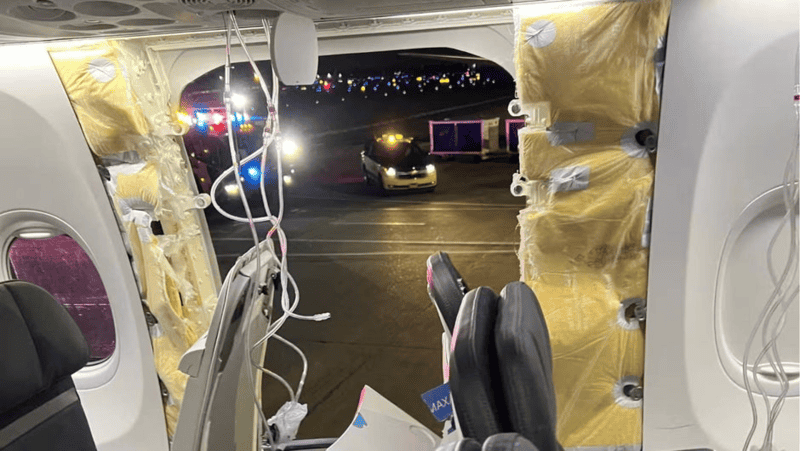

Thankfully, it appears that the seat that was closest to this plugged door of the Alaska MAX-9 was empty.
Sure, it's empty now.
  • Haha
Likes sbrothy, FactChecker, DaveC426913 and 3 others
A kid next to the door got his shirt ripped off :oops:

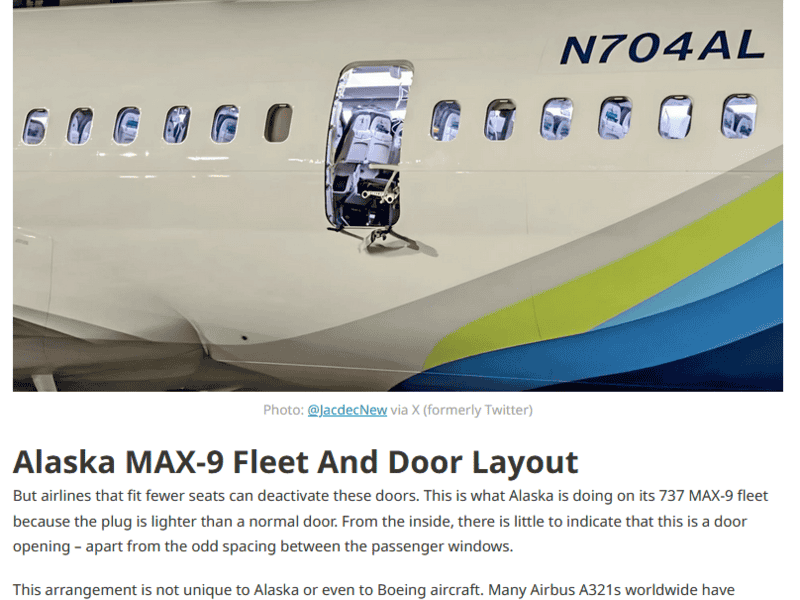

It's a "door plug" not a "plug door". They are not doors.
The 737MAX has space for two pairs of aft doors. In a very high density configuration there needs to be more doors. On non-ULCC carriers, this is not required. In this case, there is no "deactivated" door. It won't open, period (well, that's the plan).
My friend at Boeing sent me some information. The plug is held by four bolts, one in each corner. Somehow multiple bolts failed.

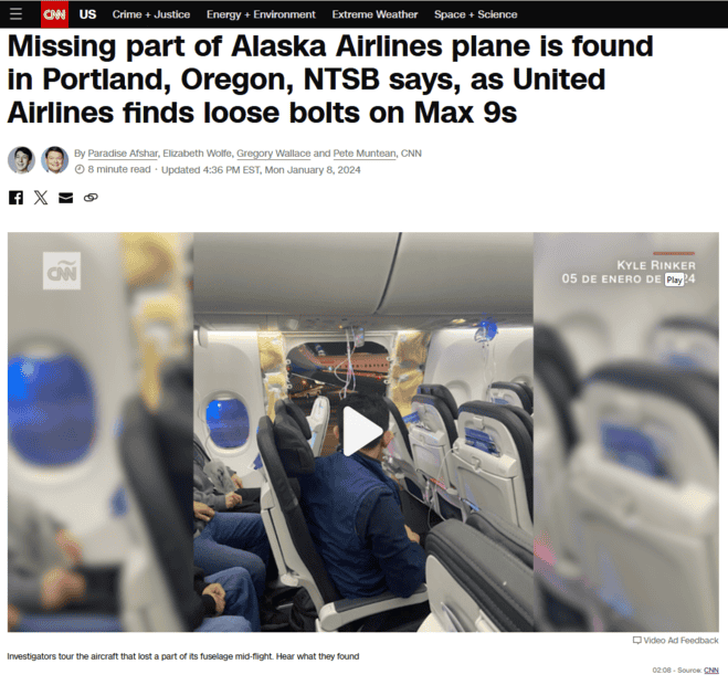

So now I'm a little more confused (what's new?)...
The reports and the pictures of the opening seem to show little structural damage, other than the missing door plug:
https://www.phonearena.com/news/iPh...flight-that-lost-a-door-plug-mid-air_id154105

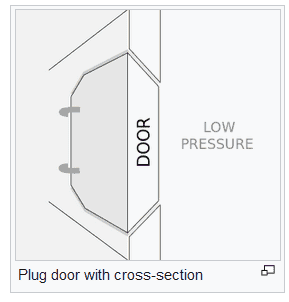

But the Wikipedia article seems to suggest that the door plug should have been mostly inside the fuselage, sealed by the higher pressure inside the cabin compared to outside at 10k+ feet:
https://en.wikipedia.org/wiki/Plug_door
So if the Wikipedia sketch is accurate, shouldn't there be a lot of torn up fuselage left behind as the Plug Door was ripped off of the airframe? Or is the Wikipedia drawing incorrect for the Boeing aircraft, and there were literally only 4 bolts holding that Door Plug against the difference in air pressure?

As mentioned above, it is not a plug door. We need a different drawing.
Better link please? :smile:

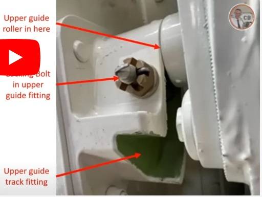

This is all explained in the video in post #9. The bolts don't hold the door horizontally, they keep the door from moving vertically to "unlatch" from the structures that resist the horizontal Δp force.
I just watched that video. It is 18 minutes long, but is very clear with some good photos and explanation of how the plug works.

Alaska and United Airlines found loose bolts on the door plugs on several of its grounded 737 Max 9 planes days after a door plug blew out of an Alaska Airlines plane while it was in-flight.
https://www.seattletimes.com/busine...olts-on-door-plug-when-inspecting-its-max-9s/
Also, Juan Browne reported that Boeing removes and reinstalls the door plug after they receive the fuselage from Spirit to install the aircraft interior.

DaveE said:
"Since we began preliminary inspections on Saturday, we have found instances that appear to relate to installation issues in the door plug – for example, bolts that needed additional tightening," United said in a statement..."
The bolt physically traps the guide roller, preventing it from moving "down" in the track. Looks like it will perform this function regardless of how "tight" it is -- as long as it is present. Were they even present? Or maybe the cotter pins were missing and the castle nut vibrated off, and then the bolt escaped. All four of them.
Likes russ_watters, berkeman and dlgoff

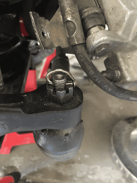

And "loose bolts"? The Cotter pins would have to have been missing for that to happen, no? I suppose if Boeing reused the Cotter pins after the reinstallation, they could have failed and allowed the nuts to back off, but I can't imagine the technicians reusing Cotter pins.
@Flyboy -- You aren't allowed to reuse Cotter pins during maintenance, right?
  • #47
berkeman said:
Great video, thanks @DaveE
No, never.
You use a bent nail instead.

  • #49
berkeman said:
And "loose bolts"? The Cotter pins would have to have been missing for that to happen, no? I suppose if Boeing reused the Cotter pins after the reinstallation, they could have failed and allowed the nuts to back off....
This is what caused my in-flight incident...
  • #50
I missed the memo, but am glad you are still with us...
