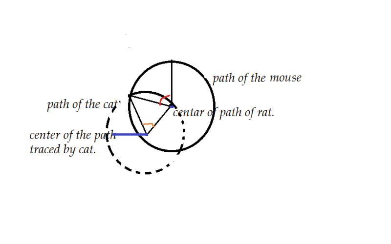

Before solving this problem I tried make a figure of this question.Here it is.
Hint given in my book says that in this problem angular velocities of cat and mouse are equal.
I know that angular velocity is change in angular displacement upon time.I am not sure about my figure.Please tell me if it is right or wrong and the angular velocity of cat and mouse are equal.It would be nice if you explain it with a figure.

Your figure is not correct .
Look at the attached picture .Red dots are location of mouse and blue represents cat .
If you join the blue dots you will get the path traced by the cat.
Let at t=0 mouse be at the top of the circle and cat at the center of the circle .In time t the line joining the mouse to the center makes an angle θ with the vertical .
What angle does the line joining the cat to the center at time t make with the vertical ? What does that tell you about the angular velocity of the two ?

Yes it also makes the angle [itex]\theta[/itex].
When I join the blue dots I got the path traced by the cat.It is an arc.This arc will be the part of a circle.Why did you not calculate the angular velocity of cat w.r.t to that center of the path traced by the cat .(Why did you not calculate Angular displacement of cat w.r.t to that center of the path traced by the cat)
Sorry for the figure it is not clear.
Right .
But the circle will not be like the one you have shown in your picture .Anyways forget about completing the circle .It is not required .Knowing that the cat will follow a curved path is sufficient for us.
This is not the way angular velocity of cat is calculated .We need to consider only one circle i.e I have shown in the figure in earlier post .The reference point is the center and reference line is the vertical line .
