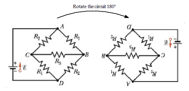

In the following circuit, the battery has emf ε = 12.7 V. The resistors are R1 = 2000 Ω . R2 = 3000 Ω, and R3 = 4000 Ω. What is the current through resistor R2 ?
Kirchoff's Rules
V=IR
i0 (into A) - i2 (current into resistor 2) - i3 (current into resistor 3) = 0
Then what happens at C and B?

There may be simpler ways to solve this, but just go ahead and write the KCL equations and try it that way. Please show your work... :smile:

i0 - i1 - i2 = 0
i3 + i1 - i4 = 0
i2 - i3 - i5 = 0
-i2R1 - i3R3 + i1R2 = 0
-i5R2 + i4R1 + i3R3 = 0
12.7 - i1R2 - i4R1 = 0
The currents are as follows from i0 to i5
.0052
.0024
.0028
.0004
.0028
.0024
Since the ones through R1 and R2 are identical, it does seem like there is an easier way to solve this, but how?

12.7 - i1R2 - (i1 + i3)R1 = 0
i3R3 - (i1+i3)R2 + i5R1 = 0
i0 - i1 - i2 = 0
i2 - i3 - i5 = 0 or i1 + i3 - i2 = 0

Yes, the currents through R2 are the same and so are the ones for R1 because reversing the polarities would give an identical result.
So that means i4 = i2 and i1 = i5
i0 - i1 - i2 = 0
i2 - i3 - i1 = 0 or i1 + i3 - i2 = 0
12.7 - i1R2 - i2R1 = 0
i3R3 - i1R2 + i2R1 = 0
But I'm not all convinced about the reversing polarities proof. Who's to say that once the current passes through the bridge and all the other junctions, it's the same?

Symmetry says so. If you can flip or rotate a circuit about one or more axes of symmetry and the result is identical to the original circuit, then the resulting circuit must behave identically to the original and the symmetric pairs of circuit elements must display the same behavior (current, potential difference).
Take your original circuit and rotate it 180°. Doing so cannot change the circuit behavior since no connections have changed (the topology remains the same).
Note that the bridge circuit still has the same values of resistance in all the same locations. The potential supplied by the voltage source has the opposite polarity in this view (negative at top rather than positive at top), but the polarity that we assign + and - potentials and current directions are just a matter of convention. You can change from assuming positive charge carriers to negative charge carriers without affecting any equations. So the symmetry pairs of resistances must carry the same currents in both orientations.

Are you trying to say that the current into point A for the non-rotated circuit is the same as the current flowing into point D for the rotated circuit?
The magnitude is certainly the same. Change the polarity of the voltage source and the signs of the currents will agree too.
Besides, how could they be different, since the same current that leaves the battery must return to it?

I see, so only currents through same resistors will have the same magnitude?
Rephrase that as "The currents through the symmetrically paired resistors will be the same" and you would be right. Don't overspecify by saying "only". Some circuits may have resistors of different values that happen to have the same magnitude of current.
