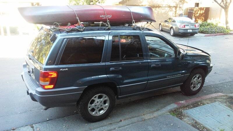

The "Trucker's Hitch" knot might work for this. I use it all the time with rope to tie loads on top of my Jeep. Maybe give it a try to see if it works with monofilament in your application:
But woe betide you if neglect the final incantation of slapping the roof twice and uttering "That's not going anywhere!"

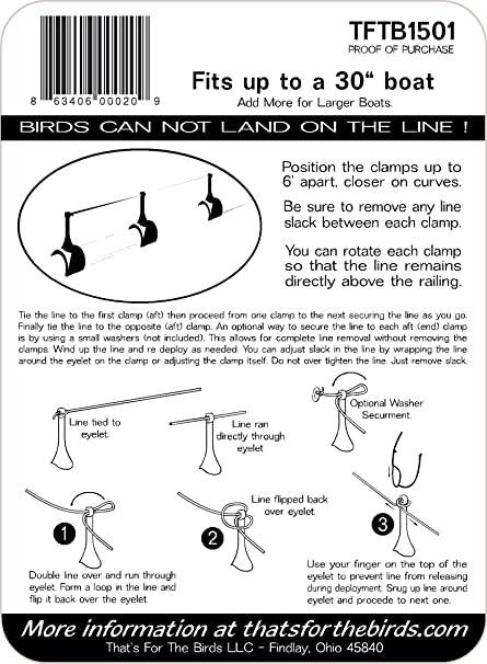

Many thanks to all for the excellent suggestions. For information, I used @DaveC426913's suggestion in Post #2 and hung a small weight (a rolled up strip of some old roofing lead) on the end of each line.

DaveC426913 said:
A 30" boat you say...
It seems to be the smallest boat on which a bird can land. :smile:
Likes DaveC426913
If the word "boat" appears in an ad, you can add some zeros onto the price of anything. There was no price on the Amazon ad.
