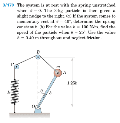

System of spring and pendulum
L=T-V
Hello! I have some problem getting the correct answer for (b).
My FBD:
For part (a) my lagrangian is
$$L=T-V\iff L=\frac{1}{2}m(b\dot{\theta})^2+mg(b-b\cos\theta)-\frac{1}{2}k\boldsymbol{x}^2,\ where\ \boldsymbol{x}=\sqrt{(1.25b-b)^2+(b\sin\theta)^2}-(1.25b-0.25b)$$
Hence my equation of motion become
$$\frac{1}{2}mb^2\ddot{\theta}+mg(b-b\cos\theta)-\frac{1}{2}k\boldsymbol{x}^2=0$$
solving this gives me the spring coefficient $$k=111.92\ N/m$$.
for part (b):
when $$\theta=25^{\circ}\ and\ k=100\ N/m$$ then
$$\frac{1}{2}mb^2\dot{\theta}\frac{d\dot{\theta}}{d\theta}+mg(b-b\cos\theta)-\frac{1}{2}k\boldsymbol{x}^2=0\iff mb^2\dot{\theta}\frac{d\dot{\theta}}{d\theta}+2mgb(1-\cos\theta)-k\boldsymbol{x}^2=0\iff \dot{\theta} d\dot{\theta} = \Big[\frac{k\boldsymbol{x}^2}{mb^2}-\frac{2g}{b}(1-\cos\theta)\Big]\ d\theta$$
$$\int_0^{\dot{\theta}} \dot{\theta} d\dot{\theta} = \int_0^{\frac{25\pi}{180}}\underbrace{\Big[\frac{k\boldsymbol{x}^2}{mb^2}-\frac{2g}{b}(1-\cos\theta)\Big]}_{-1.7001}\ d\theta\Longrightarrow \frac{\dot{\theta}^2}{2}=0.74384\iff \dot{\theta}=\sqrt{2\cdot 0.74384}=1.2197\ rad/s\Longrightarrow v=r\omega=b\dot{\theta}=0.4\cdot1.2197\approx 0.48788\ m/s$$
The answer should be v = 0.522 m/s but I can't seem to get it right, would really appreciate it if anyone could help me out!

I don't think your spring potential energy is correct. I assume the ##x## on your diagram labelled next to the curved line segment is the arc length traversed by the mass (in which case I have no idea why you use Pythagorean theorem... it should just be ##x = b\theta##, not ##x=\sqrt{(1.25b-b)^2+(b\sin\theta)^2}##), however this length isn't relevant to the extension of the spring.
(N.B. Also you should not use bold font ##\mathbf{x}## since it is not a vector; just call it ##x##)
The distance you actually want is the magnitude of the vector ##|\overrightarrow{AB}|##,$$|\overrightarrow{AB}| = b\sqrt{\frac{41}{16} - 2.5 \cos{\theta}}$$from this you subtract off ##0.25b## to get the extension ##\delta## of the spring,$$\delta = |\overrightarrow{AB}| - 0.25b = b \left( \sqrt{\frac{41}{16} - 2.5 \cos{\theta}} - 0.25 \right)$$Then the Lagrangian should read$$L=\frac{1}{2}mb^2 \dot{\theta}^2+mgb(1-\cos\theta)-\frac{1}{2}k b^2 \left( \sqrt{\frac{41}{16} - 2.5 \cos{\theta}} - 0.25 \right)^2$$
I ran into the same integral using the lagrangian you defined
Really? Because you defined some parameter ##x## as$$x =\sqrt{(1.25b-b)^2+(b\sin\theta)^2}-(1.25b-0.25b)$$which doesn't seem to make sense geometrically and doesn't equal my extension ##\delta##. When you plug ##\theta = 25^o## into your ##x##, you get a negative number, which should be a sign that something is off.
Sorry it's a typo that I just realized,
$$x=\sqrt{(1.25b-b\cos\theta)^2+(b\sin\theta)^2}-0.25b$$
if we can ignore the notation and geometric point of view for now, it just bothers me why I can't get the same answer using lagrangian. I think that using $$v=r\omega$$ relation messes it up, because I can't seem to find the error.

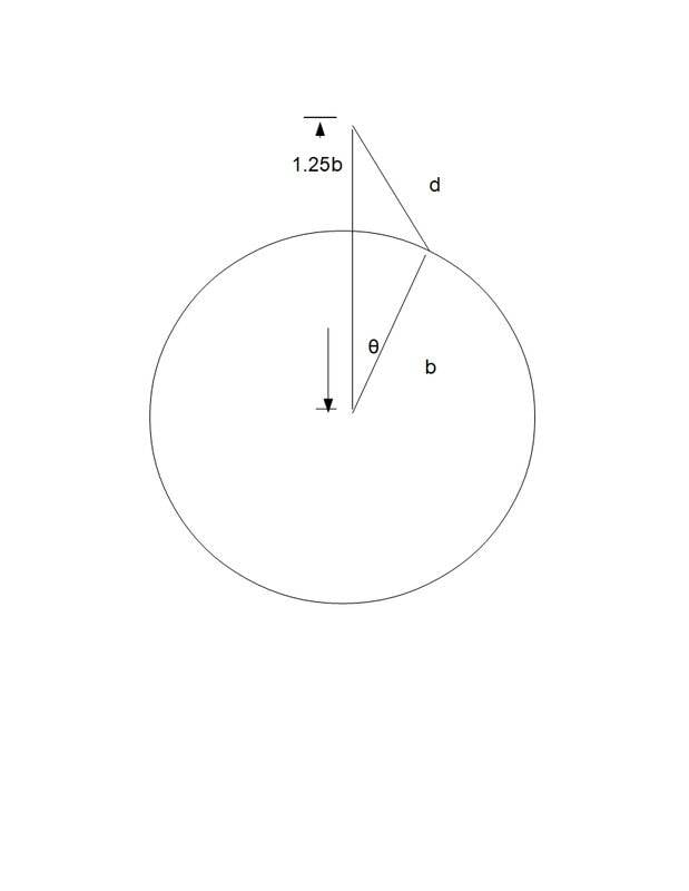

Two observations about your problem:
1. In the diagram below
##d^2=(1.25b)^2+ b^2 - 2(1.25b)b\cos(\theta)##
##d(\theta)=b\sqrt (2.5625-2.5\cos(\theta))##
The spring extension is ##d(\theta)-.25b## and therefore the spring potential energy is ##\frac{1}{2}k(b\sqrt (2.5625-2.5\cos(\theta)) - .25b)^2##
2. You can show, using the chain rule,
##\ddot{\theta}=\dot{\theta}\frac{d\dot{\theta}}{d\theta}##
From this if you have,$$\ddot{\theta}=f(\theta)$$
you can integrate to get$$\int_{\dot{\theta_{init}}}^{\dot{\theta_{final}}}\dot{\theta}d\dot{\theta}=\int_{\theta_{init}}^{\theta_{final}}f(\theta)d\theta$$
