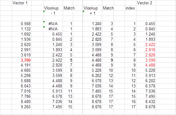

Hello,
I am trying to do the following:
I have two inputs that are very large files - I extract the first column of each so I have two vectors of ~2-5mil by 1. This is timing information. The goal is to extract the indices of each vector where the time in one vector is within a certain window of the other.
Originally I was going to work in Matlab to do:
for j = 1:L1
for i = 1:L2
timediff = (1t(j)-1t(i)); %time diff
td(j,i) = timediff;
end
end
where L1, L2 are lengths of the vectors, 1t,2t are the vectors. Then I would find the indices within my window.
This however will generate a massive matrix which Matlab cannot handle. is there even a code which can? it is too big.
alternatively, how can I come to a solution for this problem without the big matrix? Can I compare one element from one vector to all elements of another vector and only save the value in my window so I don't have to make this big matrix?
any help is appreciated!

I am thinking to use ismembertol but this is not unique and I want values of vector2 within coincidence window after vector1, so not absolute comparison
When you say large how large?
If MATLAB can't handle the array then you will need to read parts in and process them.
Have you looked at python and numpy? And maybe pandas?
A sql database comes to mind giving you a lot of flexibility to manipule and select your data.
A simpler solution would be a random access binary file. The revord index would correspond to one of your array indices. Or you could make a composite index from your indices and the dimensions of your array to find individual cells.
The random file approach makes it tough to do matrix operations though like a matrix multiply. Youd be reading and writing a lot of data.

So for each component of the first vector you need 2 values: an index where the time window opens and a (higher) index where the time window closes.
Idem vice versa.
Four arrays is a lot better than a huge matrix...
Hi BvU,
I agree that 4 is better than one big one. I just do not know how to implement what you mean. I need indices corresponding to values of first vector within window of second vector. is what you're suggesting giving me values of first vector within window of itself?
Excel example: window size is ##\pm 1##
Column Vector 1 is rand() + value of cell above.
Vector2 idem.
Column Vlookup -1 A cell looks up "value of cell to its left - 1" in vector 2
Column Match looks up position of value in cell to its left in vector 2
Column Vlookup +1 A cell looks up "value of cell to its left in Vector 1 + 1" in vector 2
Example: 3.7 in vector 1 yields positions 5 and 9 in vector 2
Likes sysprog and FactChecker

The approach I described would do the opposite, but you can just switch the two arrays to get what you want. As you progress, one-by-one, through the second list, search through the first list to find the indices that meat your criteria and collect a set/structure of them for that second-list item. Then move on to the next item on the second list.
But @BvU 's suggestion is a good one. Just keep track of the smallest and largest index in the first list that meets your criteria. (If none do, set the smallest and largest to a negative number.)
Lemme guess: you simply want the index of the nearest value in the other vector. That's only one array (per vector) :biggrin:
Likes sysprog
Hi BvU,
Yes sorry if my initial explanation was not clear. I am trying this in MATLAB where I have vector 1; and vector 1+window
Then I search for indices of vector 2 that lie between these values, running through each value for vector 1, vector 1+ window
This is taking very long and I still have no result. Is there a more efficient way to do this with such large data files?
Thank you again
It's easy to find the first item in your second array that's after each item in your first array because they are sorted. Find the answer for the first element in your first array, and the answer for the second element must be the same or later. The answer for the third element must be the same or later than that for the second element. So you don't have to search the entire second array each time - just start where you left off last time.
Your major problem is sorting out how to break ties, where the same element in the second array is the best match for several elements in the first one. There are several ways to do this, but you need to decide what you want to happen.
