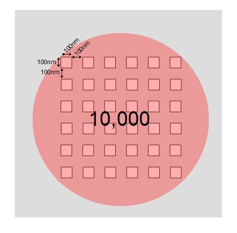

Hi everyone, let me propose an experiment to see if you agree with my points. There is a 1cm2 1-micron thick aluminum substrate with a matrix of 100x100 nano-holes each with 100x100nanometers cross section separated by 100nanometers. Then, we focus a 1W laser with visible wavelength:
1- UNDETECTABLE:
The matrix of nan-holes is equivalent to a square of 10,000x10,000nm which is a surface of 1E08nm2 = 1E-010m2
The 1W laser produces 1J per second which is 1 kg⋅m2⋅s−3 in the calculated surface of 1E-010m2 equals to 1E-010J= 0.1 nanowatts.
So, even assuming total transmission, such 0.1 nanowatts are undetectable by conventional high sensitivity optical power sensors (normally, 10nW minimum detectable power).
2-ALTERANTIVE:
A 5W laser is used for non-industrial laser cutting so to avoid burning the 1-micron substrate, 1W was chosen. However, even increasing the power to 4W would still make it undetectable. A solution could be using a 100W high power LED plus some lenses. Or even the following 1,500W LED:

Being nano-holes at the subwavelength scale of light, no optical transmission is posible.
So, thanks for reading and let me know your thoughts.

James_AA said:
TL;DR Summary: An optical experiment is proposed to validate points
Where did you get that idea from? The attenuation of a small hole increases with size but it is never complete.
and could you walk me through that one?
Your array only spans (100* 200nm) = 20 microns, not 1 cm, so your disk is mostly solid and nontransmissive. What area of the disk is illuminated by your 'focused' laser beam? What "optical experiment" are you proposing, and what "points" are you trying to validate?
