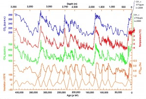

Warming the planet has some risks, and it could be argued if those risks are major or minor,
but cooling the planet has some very real major risks associated with it.
There may or may not be a warming tipping point, but there is almost certainty a cooling tipping point.
The ice core records show we are near the top of an inter glacial warm cycle, and the cold periods are much more common than the warm periods.
ice core records
