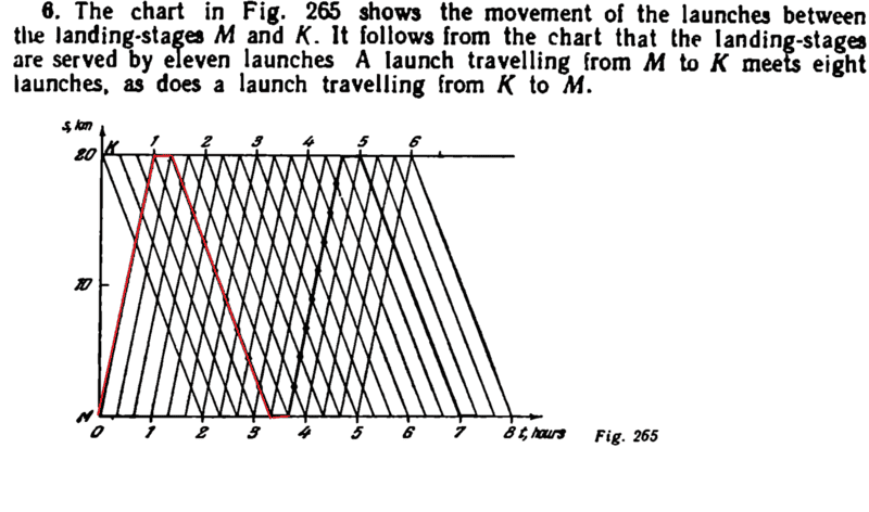

I am the OP for the problem and I think the time has come for me to look at the solution as given by the authors. Thank you all, especially @haruspex and @kuruman, for your inputs.
I want to start with the problem statement.
Problem statement :
Solution (ours) :
##\quad\text{(1) There are }\mathbf{11}\;\text{launches operating between towns M and N}##
##\quad\text{(2) and (3) From both M to N and back, each launch encounters } \mathbf{10}\;\text{launches}##
Solution (text) :
Revision : I can see that the authors have done it via a space-time diagram. I have drawn the motion of the first launch from M to N and back in red ink (##\color{red}{\rule[0.4pt]{20pt}{1pt}}##) till it is ready to travel again. In that time, we can count four launches that start from N (or K) and six launches that start from M which verify that there are a total of 11 (=1+4+6) launches in operation.
The authors say that each launches encounters 8 launches during its motion towards or return. Hence, it means that only a "meeting" on water is counted as a meet and not one which happens at either station or M or N.
I think our method of doing it was easier. More so, why draw so many space time lines when they could have stopped where the red line that I drew ended?

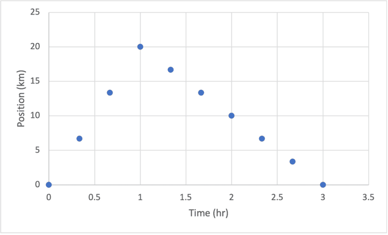

I just figured out the positions of each launch on a spreadsheet over a 3 hr interval which is the time for a round trip (not a cycle which is 40 min. longer) and made a plot (see below). The calculations were done in 20 min increments. Then I counted dots. Note that there are two dots on top of one another at ##t=1~##hr. One is just leaving for the return trip and the second one is just arriving.
