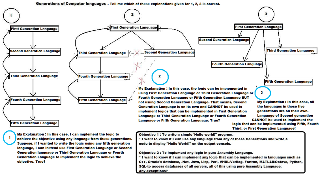

Am I saying anything? Yes.
Please see the figure below.
Question 1:
In the above figure, I chose figure 1 as my answer. And I do not know if I can develop graphics and GUI using pure assembly language. But, I think that it is possible to even draw figures, graphics and develop graphical user interfaces/windows and applications/softwares using pure assembly language. Correct me if my understand is wrong.
I know that, C language was used to build JVM and JVM makes codes run independent of all architectures. And if C language is third generation language which came after assembly language which is second generation language. Then I get an impression that C language was designed by taking the ideas of Assembly language, then how come we cannot write web applications in pure assembly language if we intend to write the same web application in terms of implementing it by implementing JVM code indirectly and Web application code in the same assembler's editor. And then assemble it. Create an assembler file compatible with web standards and put it on the web.
Question 2:
I mean, If I want to write web application code in such a way that it is able to run on all platforms then I can write it by even implementing the 'JVM' code and the web-code in the same assembly language's editor window. Is not that a possibility? I am not trying to reinvent the wheel. I am sure that the elite peers and the researchers have already worked and studied it. But I am just curious to know if there is any tiny possibility of doing this using pure assembly language. Please see the figure above.
I get an impression that the mere purpose of doing all of this (going to higher level of abstraction) is to get/impose security in a wayward manner which is not elegant at all.
Thanks and appreciation.
  • #33
The statement
and others you have made tells me that you have a fundamental misunderstanding.
ANYTHING that can be done on a computer can be done in assembly language.
You would be utterly insane to actually DO it, but it CAN be done. To recreate the OS utilities, including graphics routines, that make many thing easy to do COULD be redone by you in assembly language, but probably not in one lifetime.
After all, whatever code you start out with, it RUNS as machine code and assembly language is just a literal translation of machine code into human-readable form.
