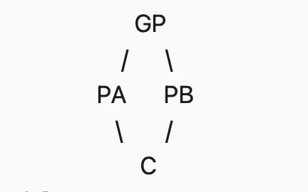

Java is a single inheritance language, which means a class has a single parent, who may in turn have a single parent. C++ allows for multiple parents and the use of mix-in classes. The multiple inheritance of C++ has caused many programmers problems.
Consider the case of a child class C inheriting everything from parent classes PA and PB. PA and PB have been implemented to inherit from GP, the grandfather class. Inheriting means that the child class can change attributes in the grandfather class GC.
The question is, which path do we use to reference the grandfather attribute?
1) C->PA->GP
2) C->PB->GP

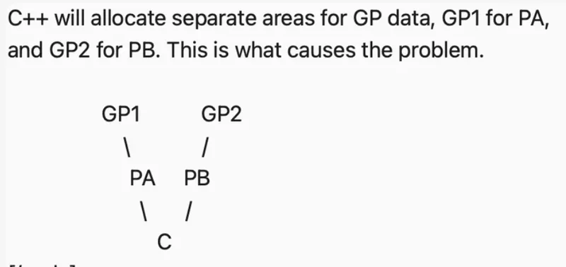

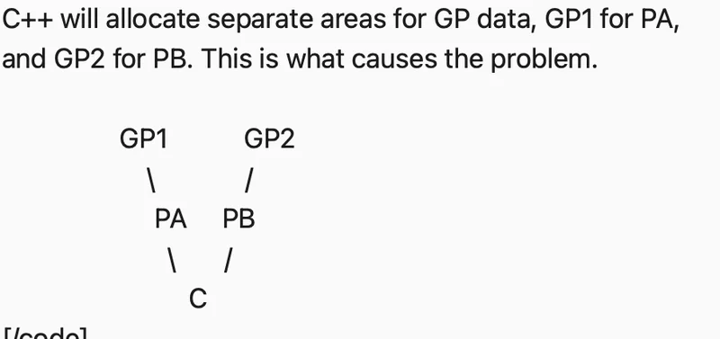

In C++, separate memory areas are created, meaning it's essential to follow a convention and always use the first approach. But if you forget and mix the two, you'll have a fun time diagnosing the problem.
