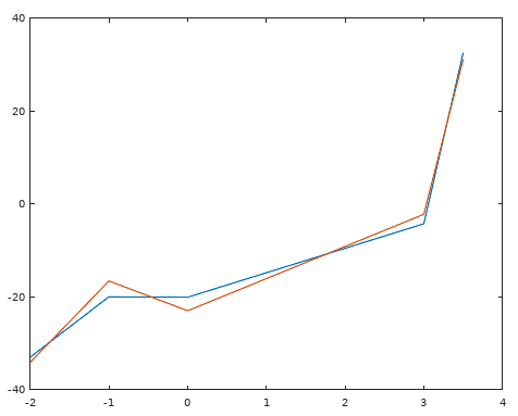

Hey mathmari!
I checked the solution $a=(A^T A)^{-1} A^T y$, and found the same solution that you did.
If I graph it, I get:
https://octave-online.net/
xx=[-2 -1 0 3 3.5]';
yy=[-33 -20 -20.1 -4.3 32.5]';
A=[ones(5,1) xx xx.^2 xx.^3];
ATA = A'*A
ATy = A'*yy
a = ATA\ATy
plot(xx,yy)
hold on
plot(xx, A*a)
That looks pretty close doesn't it, even though $p(0)$ is slightly off? (Wondering)

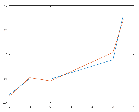

And yes, your solution with the derivatives set to zero should have the same result. (Worried)EDIT: Now I've also plotted it with the $a$ you found with the derivatives:
a_diff = [-21.6611, -7.08875, -2.06057, 2.33768]'
plot(xx, A*a_diff)
Hmm... that's not the same is it?
The first one does look better though.
Perhaps there is a mistake? (Wondering)EDIT 2:
If I calculate the residu $\|Aa-y\|$ in both cases, I get:
Code:
>> norm(A*a-yy)
ans =  5.2292
>> norm(A*a_diff-yy)
ans =  7.5340
In other words, the solution with the derivatives did not find the lowest possible residu.
It confirms that there must be a calculation mistake. (Worried)

I checked my calculations again and I saw that I had a wrong sign. Now I get \begin{equation*}p(x)=3.05677x^3-2.78419x^2-12.2439x-23.0084 \end{equation*} which is approximately the same as the second one. Do we have have to get the exactly same polynomial or is it correct that we get approximately the same one? But what about the value of the polynomial at $x=0$ ? Shouldn't it be as the given value? (Wondering)
Good!
The first 4 significant digits of each coefficient are the same.
I think it means that intermediate results of the numbers have been rounded to perhaps 5 or 6 significant digits.
The results should be exactly the same, but of cause they are sensitive to rounding.
Anyway, they are close enough that I believe that the calculations are correct now. (Thinking)And no, the value of polynomial is not expected to be the same as the given value at $x=0$.
It is an approximation after all.
We can only fit a cubic polynomial perfectly through 4 points.
Since 5 points were given, it is normal that every point is slightly off from the given value.
The squared sum of the differences is merely as low as possible. (Nerd)
