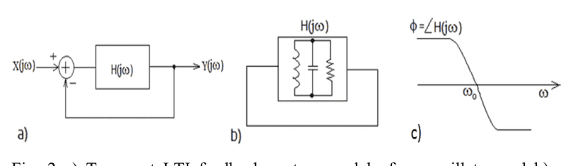

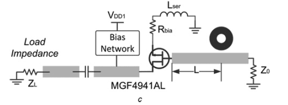

Hello,I want to created th following system.From the articles I see that we input noise to the amplifier then the noise gets amplified and we compare thefeedback from the output(s11) to the noise.
few questions:
1. where is the comparation of the feedback in the topology below.
I cant see here the feedback.
2. at resonance we have phase of 0,what is the effect of the feedback here?
Thanks.
The inductor, LSer is the feedback element in making the transistor circuit a negative-impedance stage. The resonant circuit on the gate determines the frequency. Although unstated, I suspect that the actual feedback is the transistor's internal stray coupling. This is based on my reading of pgs. 2 thru 4 of your attached PDF file.
