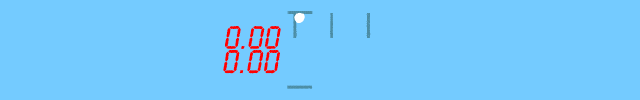

This is the "transverse" light clock, in which the light bounces back and forth in a path that is transverse to the direction of relative motion of the two frames.
If you also add a second light pulse and a second mirror, aligned parallel with the direction of relative motion, with the length in the clock's rest frame the same in both directions (so the two pulses, after being reflected off the mirrors, arrive back at the origin at the same event), you can then analyze this clock in the frame in which it is moving and recover length contraction as well as time dilation. (This configuration is similar to the one used in the Michelson-Morley experiment, except that we've left out measurement of interference fringes.)
Likes bhobba and vanhees71
Something like this:
Likes PeterDonis, Motore and FactChecker

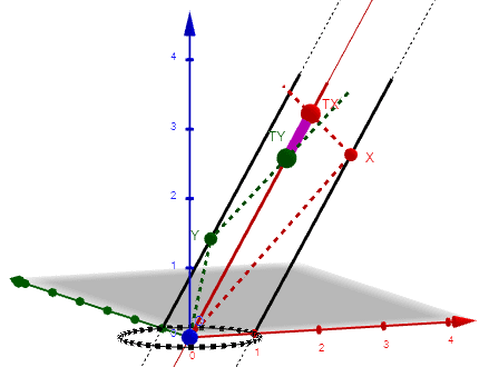

This second clock is the "longitudinal light clock".
The usual story is that to make longitudinal light clock
agree with the time-dilation observed in the "transverse light clock",
the longitudinal light clock must be length contracted.
(Note: No contraction in the transverse direction using the "nails on a meterstick" argument
https://www.physicsforums.com/threads/length-contraction-question.121833/#post-997499 )
You can find this in, e.g., Griffith's Introduction to Electrodynamics 4e, Ch 12.
As @PeterDonis notes, this is essentially the Michelson-Morley apparatus, as described in special relativity to explain the null result, which was unexpected from a pre-SpecialRelativistic viewpoint.
( https://en.wikipedia.org/wiki/Michelson–Morley_experiment ).
The apparatus was a clever way to measure the expected time-difference in the round trips since high-precision clocks weren't available then.
You can see the geometry involved in the MM-apparatus (the transverse and longitudinal light clocks)
in a [seemingly uncommon] spacetime diagram of the MM-apparatus.
pre-SR (without length-contraction): TX and TY are distinct reception events
SR (with length-contraction): TX and TY are coincident reception events
In addition to this txy-spacetime diagram,
you may wish to view
the xy-plane (for the transverse light clock) and
the tx-plane (for the longitudinal light clock)
