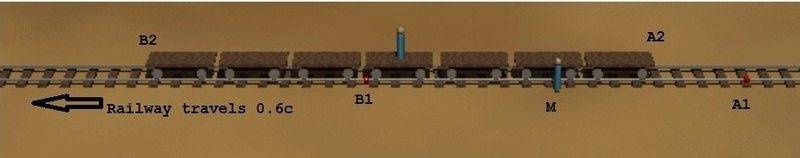

Simultaneity of events!
Janus said:
[PLAIN]http://home.earthlink.net/~jparvey/sitebuildercontent/sitebuilderpictures/trainsimul2.gif[/QUOTE]
Good, very Good, Janus.
I remember once, some one sent me a clip about simultaneity of events using clock synchronizations.
Using two clock and one observer. Stays and moves.
Was that you?
Now I understand that there's another thing to study to understand relativity: Simultaneity of events

Janus' train is a very good example.
Is the Lorentz transformation derived from this example? The railway somehow has to be contracted at the picture below. If not, then the train will think he's chasing light.
There's also a simultaneity of events as the front train hits the trigger first, compared to the to picture. The front and the back of the train hit the trigger at the SAME time.

OK, at first sight you are accounting for everything that is relevant (great!), but there is an error somewhere. Likely you got the time difference wrong, as you give much less details than is necessary for a correct calculation. Here's my calculation of the measurements in the train, as calculated from the perspective of the platform observer :
We put c= 300000 km/s. The train goes at 0.9c => γ = 2.294 -> Ltrain = 130767 km.
Total measured time for a signal from rear clock to front of train and back according to platform observer:
forward (130767 km) / (30000 km/s) = 4.3589 s. (Check: in 4.3589s the light has moved 1307670 km and the train 9/10th of that; difference is length of train).
backward (130767 km) / 570000 km/s) = 0.2294 s.
4.3589 + 0.2294 s = 4.588 s. That total time is measured by the train observer as 4.588 s / 2.294 = 2.000 s.
The train observer next sets the time of the front clock by sending a light signal from rear to front; he sets the front clock to read 1s more at reception than the rear clock was at the time of sending.

Instead - and it seemed as if you understood that! - the clock synchronization procedure makes the measured speed the same in both directions. By definition. As I put it:
The train observer next sets the time of the front clock by sending a light signal from rear to front; he sets the front clock to read 1s more at reception than the rear clock was at the time of sending. You correctly did so in post #21 - so now I'm puzzled at why you don't understand it next. Could it be that a concept that is clear to you from a signal in the middle, is unclear with a signal from one end? It's the same concept, only a slightly different procedure.
If so, you should perhaps try the calculation with a light signal from the middle, as you did in post #21...
As a reminder, you wrote:
"The 2 guys on the train agree to set their clocks on 5 when they receive the laser. For them, both clocks are on time " pointing to same time" since C must have same speed and it was same distance so it will arrive to both guys at same time from their perspective."
But you seem to have again completely forgotten that, as now you wrote:
" this doesn't tell that C is constant from both directions."
Indeed, length contraction and time dilation are irrelevant for that, as we told you many times - and as you even understood in your post 21. Length contraction and time dilation tell us what he will find for the total time for light to make a round trip. That should be 2 seconds and it is 2 seconds as you saw. Next, clock synchronization takes care of the one-way speed of light, just as you understood in post 21.
It tells that the average velocity is C. You could get velocity for each direction if you calculated the exact distance covered by C. instead of getting the velocity of light that I think the observer on train will measure another thing, since the observer who measures is on train.
Once more: if he divides, as he must do, 2 seconds by 2, he can only find 1 second for the time each way because he assumes for his clock synchronization that the speed of light is the same in both directions. He can then only find 300000 km /1 s for one way, and 300000 km / 1s for the other way. Because it is 6000000 km / 2s both ways and he sets the clock so as to make the speed of light the same in both directions..
he will doesn't take difference in clocks into account since he sees them synchronized
:oldconfused: That is the synchronization according to him! The whole point is that he assumes that he is in rest, and so he uses the method of §1 of http://fourmilab.ch/etexts/einstein/specrel/www/
One last time: he simply follows the procedure of §1: "we establish by definition that the “time” required by light to travel from A to B equals the “time” it requires to travel from B to A."

You were right, and for one instant you understood it...
The events of lighting lasers are not simultaneous according to the train frame.
For really the last time, this is how they synchronize their clocks:
""we establish by definition that the “time” required by light to travel from A to B equals the “time” it requires to travel from B to A."
Please tell me, how can they not find that the “time” required by light to travel from A to B equals the “time” it requires to travel from B to A, after they set their clocks such, that, as you put it, "the guys set their clocks on 5 when they receive the laser [from the middle of the train] ??
[..] I think I didn't get what you meant. If I'm one guy in front and my friend's clock at back is 1 more second, then I shall observe no difference, and If I'm measuring difference in clocks to calculate C then I will not take this 1 more second into account since I don't observe it and I'm the one who is measuring.
Sorry I cannot follow what you are saying. Are you applying the clock synchronization procedure of §1?
You replied: "Indeed, yes [That is the synchronization according to him!]"
If so, you will find the same as me.
It's really simple, secondary school stuff. for the people in the train who think that the train is in rest:
t1 + t2 = 2s
By definition (necessarily, because they think to be in rest): t1 = t2 = ½ (t1 + t2)
=> t1 = t2 = 1s
There is nothing more to it than that simple calculation. :smile:
