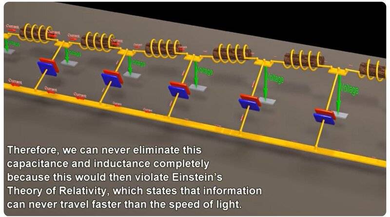

The signal travels about 1 foot in one nanosecond, 1 ns, it is then reflected by the impedance mismatch at the far end of the sloppy untwisted line. The reflection gets back 1 ns later, at 2 ns, just as the next bit is being transmitted. The line is long enough to contain one bit. You have built a resonator, not a transmission line.
For a transmission line to carry 480 Mbit/s, a minimum bandwidth of about 2 GHz is required. A 3 inch mismatched line, would resonate at about that frequency.
To radiate a 2 GHz waveform efficiently, a dipole antenna would need to be about 3" long. The 5'th harmonic of 480 MHz falls at 2.4 GHz, in the ISM band. Do you want the signal energy to remain in the transmission line, or to radiate, and interfere with wireless Bluetooth, in the 2.45 GHz ISM band?

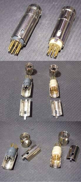

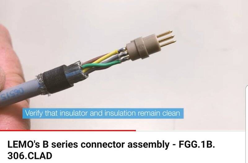

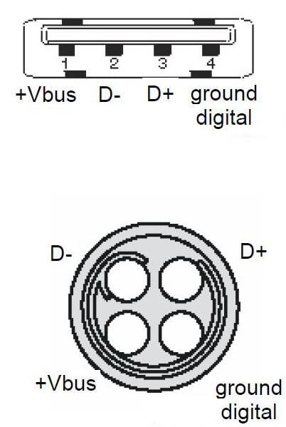

Does a LEMO plug have the same characteristic impedance as the twisted pair in a USB 2.0? If not, what will happen?
Probably not, but it will be close.
You will need to look up the impedance data on those coupled plugs and sockets. Multipole plugs tend not to work well with twisted-pair transmission lines at such high frequencies.
The impedance of a parallel conductor transmission line, is determined by the ratio of conductor diameter to separation, and the dielectric constant of the insulation.
When a twisted pair is connected to two adjacent pins on the plug, the pin separation is fixed, so the diameter and insulation must be adjusted to maintain the impedance. If you follow through the connection, you will find it difficult to avoid steps in impedance, that will look like small series inductors, or parallel capacitors, which will reflect some signal energy.

Have you (or anyone) ever built a USB 2.0 cable with LEMO 4-pin (multipole) plug at one end? Did it run at Hi speed of 480Mbps?
Certainly not I.

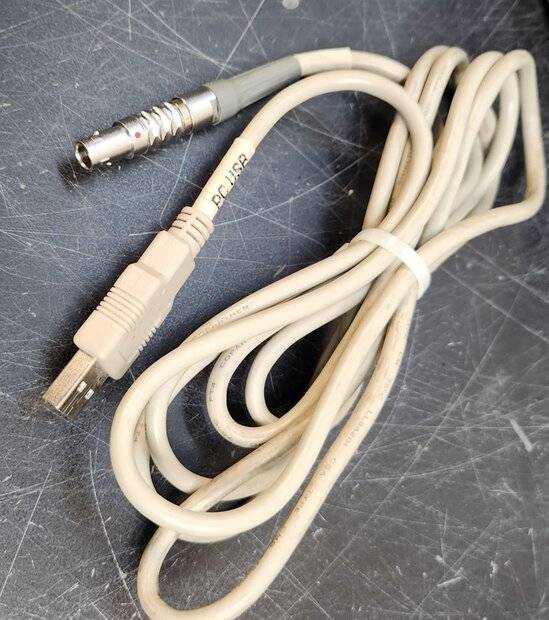

Someone has the original USB-Lemo cable. I tried zooming in the cable picture and seemed to make out the words "CMG LL84201 CSA CABLE COPARTNER FT4". I googled it and the following page comes up.
https://www.ebay.com/itm/374199291173

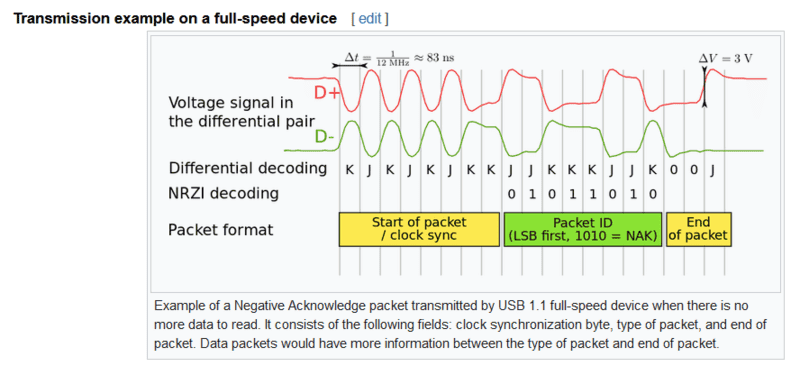

Ok. But the power souce is DC, let's say a laptop on battery or already fully charged. So when it uses the USB. It changes DC power to AC signal? Can you put it that way? I thought DC can only turn to AC using an inverter.
Edit: For an ordinary USB male plug. Is it impedanced matched to the wire? What is the impedance of a USB male plug?
If you have DC and turn it On-Off-On-Off quickly, you end up with what is effectively AC. Like this: __---__---__--__--__---__--
Technically it is "pulsed DC", but because it acts much like AC it is often called that, especially when it is changing fast and we have to worry about running into that soccer goal net. :oldbiggrin:
It is the transitions between levels that causes problems at the higher frequencies we have been talking about.
The AC at your wall outlet really is AC (Alternating Current) in that it changes polarity from + to - to + every cycle. The signals on the USB cable just change between (zero) 0 to +5 to 0 every cycle... but because of the rapid changes, it acts more like AC.

No. I just wondered how an equipment that was completely powered by DC can produce AC signal at the USB port.. I guess it's the USB chips that can do that. I was only familiar with impedance from the working of transformers. So I thought impedance can only came from AC. So this time it is chip based.
Just to re-iterate: it’s not AC. The voltage pulses from 0 to 5V, so the current doesn’t reverse.
Impedance comes into play whenever the current is changing.
Without special inserts (which ordinarily people won't add). Would the following pin configuration make the connection somehow be able to cause impedance matching for 480Mbps transfer? Notice the D- and D+ are both at the top of the 4-pinouts. This is for sake of discussion. I'm not making a cable.

And oh, I saw the folloiwng at the internet. Left side is genuine Lemo, right side is china clone.

Lemo connectors are for audio, not half-GHz RF. This thread of yours has gone on long enough, and is now closed.
