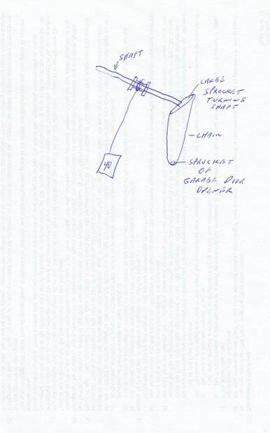

I have a garage door opener I want to use to lift 40lbs. I've read that without the spring assist it could manage 27lbs max lifting power. If I played around with the sprocket that's going on the shaft attached to the 40lbs say double or triple the diameter that's whats on the opener would that work.
Maybe, I guess. It's not really clear to me what your design is though. Maybe a sketch or a detailed description would get you useful answers.
“Give me a firm place to stand and a lever and I can move the Earth.” - Archimedes
To lift more weight, you need a smaller chain drive sprocket. That would create other problems. The sprocket is already about as small as will fit in the space available. And the bearing supporting that sprocket is the cheapest bearing that barely lasts long enough. Pulling harder shortens the life of that bearing.

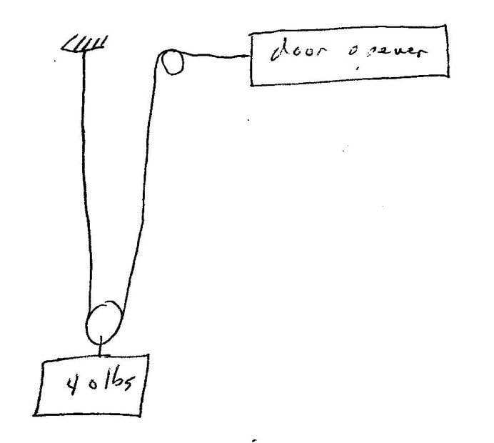

A better approach is to use a pulley to lift your load. Like this:
Then the opener only has to pull 20 lbs to lift the 40 lb load.

This is what I had in mind the sprocket on the garage door opener would turn a sprocket welded to a shaft that would have the 40lb weight on it.
You will likely only get so many turns of the sprocket on the opener. They are made to lift only so far. Gearing it down may not give you the travel you want.

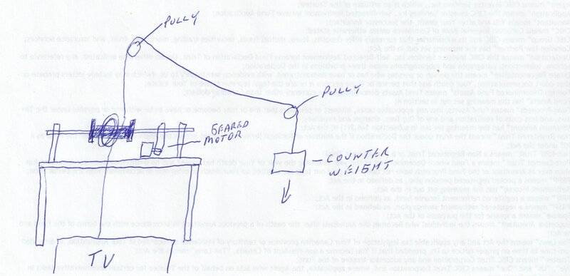

I wanted to keep everything inside the top of the box I was going to insulate it as I'm in the north. I guess I could have one cable coming through a small hole in the top. Do you think this would be ok (see attached) the cable comes through the box and raps 3 or 4 times around a reel or spool and then to the counterweight? The motor drives the shaft the reel is on. Or would it be better to have counterweight directly onto TV (weight)

Do you really need motorized operation? If you have room for a counterweight, just make the counterweight the same weight as the TV. Then a one finger push will move it up, and a one finger pull will bring it down. Friction will keep it wherever you leave it - up or down. If you really need remote operation, a stick to push it up and a string to pull it down.

No your right in your case I would not but theres something for saying "OK Google turn off TV" and the TV retracts up into the ceiling.

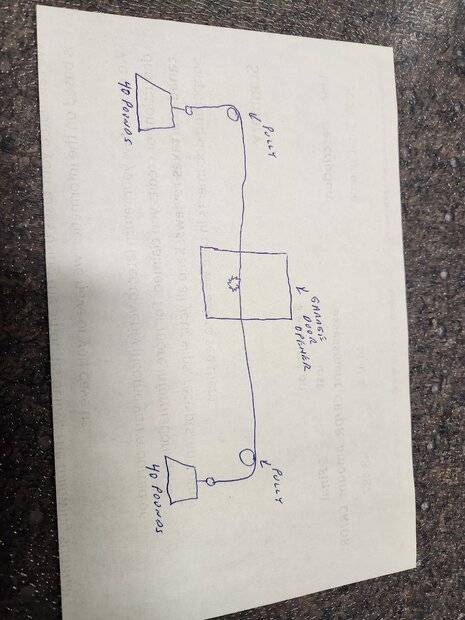

If I did it this way can I assume that there would be no weight on the garage door opener

A counterweight would still be useful - it would take a lot of load off the motor, only having to get the weights moving, not actually lift dead weight. You get two birds with one stone.
Right, the opener deals only with the friction in the system. Very similar to the "sash weights" in windows.
