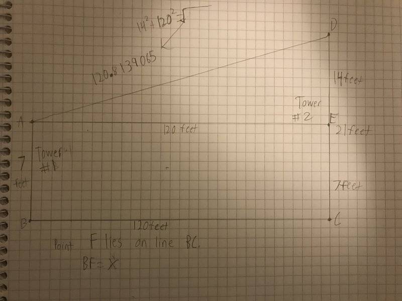

Can you make a sketch of the situation? From this you should be able to write an expression for the length of the light path.
I can. Give me a minute to photograph it.
Hint: Assume the light reflects off of the lake at a distance X from the base of the left tower. Think of the distance traveled by the light as having two parts: Top of left tower to lake (point X) and lake to top of right tower. Each part is the hypotenuse of a triangle: use a bit of trig to express the total distance traveled as a function of X.
If I am understanding the problem, I need to find the equation of line BF, take the equation's derivative (praise the almighty derivative), set the derivative equal to zero, and then solve by algebra. Where I've gotten stuck is finding out how to get the equation of BF so that AF and DF connect to the two towers as described in the problem. I'm sure that I've forgotten something extremely simple, but I'm not seeing where to go from here.

Your diagram is incomplete. Draw the point F on the surface of the lake (just guess where it is), then draw the lines BF and DF. You should then be able to write expressions for the length of the line BF in terms of x and the length of the line DF in terms of x.
Draw the point F on your diagram. (The distance BF is what I called "X".) Then draw lines AF and DF; those are the two parts of the light's path that I referred to.
Use trig to find expressions for lengths AF and DF.

In triangle abf , the only known values are angle abf = 90' and side AB = 7 feet. I don't know the hypotenuse, because to find that I need side BF, which is the whole reading I'm working this, to find BF. And I must be overlooking a trig function, because to use any of the six, I need at least another angle or side.
And technically I already know BF= 50, but working the problem backwards isn't going to teach me much.
You 'know' the side BF, it's distance is x. So write the hypotenuse AF in terms of AB (7 feet) and x.
But can I even solve that with two out of three variables being unknown?
7^2 + X^2 = C^2. C=AF
Just do as phyzguy says: Express the hypotenuse in terms of X. You're not solving for anything yet.
Good. Express C in terms of X.
Now do the same for the other piece of the path, DF.
If BF = X, what must CF equal?
So we have
AF = sqrt(7^2 + X^2)
DF = sqrt(21^2 + (120-X)^2)
CF is equal to 120-X

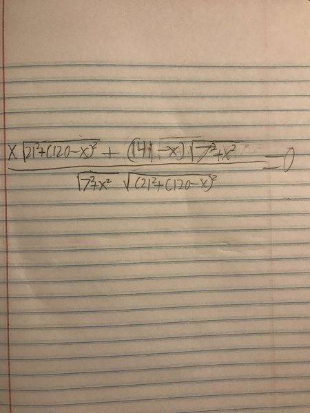

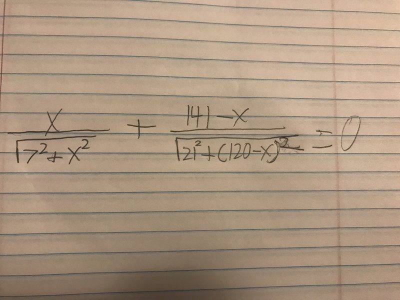

Perfect. Now you must minimize AF + DF.
I have a feeling the chain rule will be needed soon.
Oh yes.
  • #31
Stand by, mathematics in progress.
  • #32
If I recall correctly, because both expressions are of the same power: ^1/2, I can combine them without any issue, correct?
  • #33
Combine them how? If you mean [itex] \sqrt(a) + \sqrt(b) = \sqrt(a + b)[/itex], then no, you can't do that.
  • #34
So I have
(7^2 + X^2)^1/2 + (21^2 + (120-x)^2)^1/2 as the total length
  • #35
So I have
Correct. Good job. Now use calculus to find the value of X which minimizes the length.
