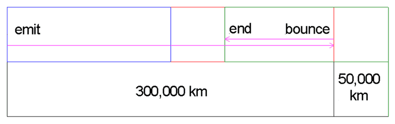

B Light Speed In Forward and Backward Directions
AlienGrey
TL;DR Summary
Thought experiment showing discrepancy in the speed of light for forward and backward light beams in a moving frame as viewed from a stationary frame
In the illustration below, a laser beam is emitted, and the time recorded, from the rear of a frame which is 150,000 km long and is moving at velocity 0.5 c to the right. When the beam reaches a half silvered mirror at the front of the frame, the frame being shown as a rectangle and using different colors for three different positions along its path of travel, half of the beam goes through the mirror to a sensor which records its time of arrival and the other half bounces from the mirror to the rear of the frame from whence it was emitted, striking a second sensor which also records the time. The frame was already up to speed when it emitted the beam at position one, shown in blue, so no acceleration effects are involved.
The time taken for the beam to reach the mirror, at position two shown in red, is 1 second in our stationary frame, having traveled 300,000 km, and the time taken for the reflected beam to reach the rear sensor is 0.33 second, the beam having traveled 100,000 km rearward (left) while the frame having moved ahead (right) 50,000 km by the time the beam hit the sensor, totaling the full length of the frame, 150,000 km, the frame's position shown in green. The one-way speed of light would be difficult to gauge in the real world, but this a thought experiment so it's a lot easier to do.
How do observers within the moving frame record the time taken for both the forward and rearward beams to be 0.5 second, as would be the case if the frame had been standing still? Or would they record the same times as we did in the stationary frame? For the time to be 0.5 second in both directions, their time would have to pass at 50% the rate of ours while the beam traveled forward, and it would have to pass at 150% the rate of ours on its rearward trip. How do you reach that outcome using a single time dilation and/or length contraction factor, considering how different they are? If you can explain how light speed can be recorded as 300,000 km/s in both directions in both frames, I think you deserve a Nobel Prize, because I suspect that Einstein wouldn't be able to do it using his equations.

In your analysis you appear to have neglected the relativity of simultaneity (which is the error in about 99% of cases when people get weird answers from analysing simple experiments).
The general recipe is to write down the ##x,t## coordinates of the various emission and reflection events in one frame, and use the Lorentz transforms to get the ##x',t'## coordinates in the other frame (not just time dilation, which is a special case of them with certain assumptions that aren't applicable here, which is why your attempt goes wrong). You can then compare the transformed distances and times and you will find that the speed of light is ##c## in both frames.
Your picture depicts a 150000 km object in the 'stationary' frame, which means its proper length would be 173200 km and any clock on the object at the emission point would record about 1.15 seconds for the round trip.
If the proper length of the object is really 150000 km, then you need to redraw the diagram showing its contracted length to be about 1300000 km which affects all the times in your description.
If there is a clock at the right side of this object in sync with the left clock in the object's frame, it will record the reflection time as half the round trip, or 0.575 seconds.

How would the length of the object change the the one-way speed of light differently depending on direction, forward or rearward? To correct both of them, the length would need to change so it's contracted when the beam travels in one direction and lengthened when it travels in the other. Since that would be implausible, the discrepancy would still exist, I would just have to do a bunch of extra calculations to change the values to conform to your speculation about objects contracting.
I illustrated the actual length of the object and the distance it traveled. You can use your theory that things contract arbitrarily if you want. You stated that the occupants would record the reflected beam's travel time as being half of the round trip time, but you could obtain the same figure for half of the round trip time using numerous combinations of different one-way trip times, that's the point of me stating that there were two sensors and each recorded the one-way trip time in the two opposite directions. So what would each one-way trip time be, using whatever object length you want to choose arbitrarily?
It wouldn't. It's the relativity of simultaneity that does that, although the length contraction is a necessary part of the calculation too.

Length contraction doesn't really address the main problem with your OP. Yes, there is length contraction in the picture, but your assumptions about the relationship between the two frames are more fundamentally flawed.
This is not what's being proposed.
What you showed was that SR is incompatible with Newtonian ideas of space and time. That's true. SR is fundamentally a theory of spacetime. You have to use the SR model of spacetime in order to say anything about it.

In the moving frame, the path is ##0.5## light seconds long. The beam takes ##0.5## seconds to reach the far end and ##0.5## seconds to return. That's just the distance divided by the speed of light.
In the ground frame, the path is only ##d = \frac{0.5}{\gamma}## light seconds long. The time to reach the far end is $$t_1 = \frac d {c - 0.5c} = \frac{2d}{c} = \frac {1}{\gamma} = \frac{\sqrt 3}{2} \approx 0.87 \ \text{seconds} $$ (as the far end is moving away from the light beam in this frame).
For the return journey the beam takes $$t_2 = \frac d {c + 0.5c} = \frac{2d}{3c} = \frac {1}{3\gamma} \frac{\sqrt 3}{6} \approx 0.29 \ \text{seconds}$$ (as the near end is moving towards the near end in this case.)
Here the gamma factor is ##\gamma = \frac 1 {\sqrt {1 - v^2/c^2}} = \frac{\sqrt 3}{2}## and gives the length contraction as mentioned above. Note that I assumed that the apparatus was ha;lf a light second long in its rest frame.
Likes Dale
PS the total round trip time in the moving frame is ##1## second. The total time in the ground frame is ##1.15## seconds. This can be seen as an example of the time dilation between frames as
$$t_{ground} = \gamma t_{moving} = \frac{\sqrt 3}{2} \approx 1.14 \ \text{seconds}$$

The length of the apparatus id ##0.5## light seconds, so it takes light ##0.5## seconds to move the length of the apparatus. That's just ##t = \frac d c##.
Likes Dale and russ_watters
PS the speed of light is ##c## (invariant) in all inertial reference frames. That's a postulate of SR.

How do we transform 0.87 seconds and 0.29 seconds to 0.5 and 0.5?
You could get that using the Lorentz transformation. Or, the way I did, by simple kinematics in each frame.
AlienGrey said:
We're not starting from the assumption that the trip takes the same time in both directions in the moving frame. We're starting from the assumption that it doesn't. If you dispute that assumption then you would have to explain why, which you have yet to do.
Yes, that assumption is dead wrong.
