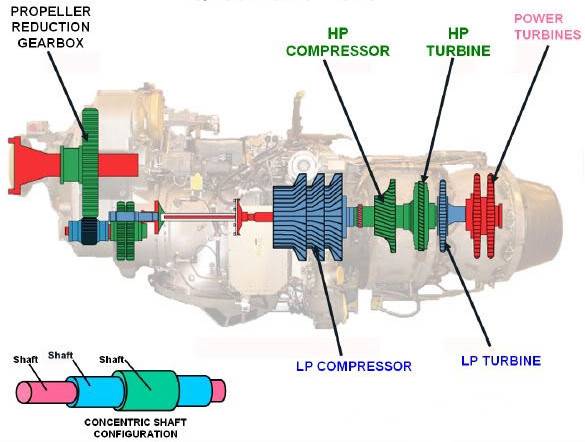

jsh111 said:
Is there any prior work that focuses on lower speed gas turbines
By design, gas turbines are high-velocity, low-torque, machines. It would be counter-intuitive to work against that. Again, when you want a lower rpm, you use a gear set:
