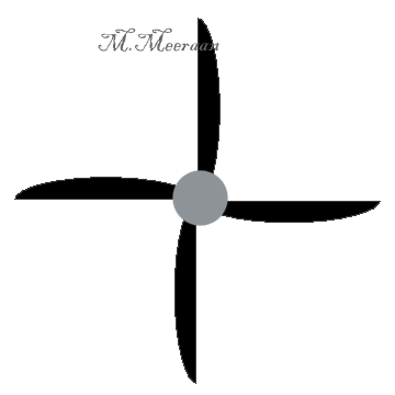

Logically, Won't the center of gravity(Geometrical center) stay still and the ends would rotate (Like in a fan). If this the case, shouldn't the answer be 0 velocity because of it being in the center?
(Zero motion at the center of fan)
No, that won't happen. Realize that there is a net force acting on the cylinder during the collision, thus the center of mass will accelerate. (Newton's 2nd law.)
The analysis by @kuruman is well worth your study and places interesting constraints on the relationship between the masses. However, such an analysis is not needed to solve the problem: conservation of linear momentum is enough. (If the author of the problem were on the ball, like @kuruman, he could have asked some interesting followup questions! I suspect he didn't do the analysis.)
Likes kuruman
Logically, no. In addition to what @Doc Al already pointed out in #5, in post #1 you calculated, and we all agreed, that the speed of the CM after the collision is ##V_{cm}=\dfrac{m}{M}v ##. To suggest now that it is zero is illogical. Of course, ##V_{cm}=0## in an inertial reference frame moving to the right with velocity ##u=\dfrac{m}{M}v ## relative to the lab frame, but the problem (and the offered choices) are relative to the lab frame where the particle is initially moving with speed ##v## to the right and is at rest after the collision.
