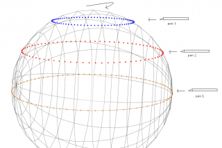

Hello,
Any solution ? Maybe I don't give good explanations.
If a sphere is spinning around an axis with its center staying fixed, how can I know its angular velocity from points at its surface recorded each minutes ?
For example, the sphere below is rotating around (0, 0, 1) with an angular velocity of pi/40 rad/min , I have 3 pens touching the sphere at different latitudes each minute (I have cartesian coodinates of these points). How can I deduce from the blue, red and orange points the same angular velocity (pi/40)?
I know how to do this with 3 consecutive points (3 minutes) P, Q and L. My rotation axis is the line of intersection of the perpendicular bissector of segments PQ and QL. Then I can calculate a good angle given this axis of rotation (from blue, red or orange points). But it is not good when this axis can change between PQ and QL ...
Can I find a solution from two consecutive points ?
Thank you
Given that each data-point will have an uncertainty related to it, you'll probably need to use some regularization approach. The exact approach depends on how much you know to start with. i.e. do you know the orientation of the axis of rotation? The radius of the sphere? Do you know the rotation is slow compared with the time interval between measurements?
You can calculate these things from many consecutive measurements of course.
You need at least three points to establish the plane of rotation, and, assuming a circle, the same three will tell you the center of the circle. The more points you have the better picture you will have.

In biology, it's not usual to work with this kind of data. I don't have experience of a physicist or a mathematician and my supervisor don't give me reference. I read the notes but I have difficulties to find a direct application for my problem.
A priori, I have no information about radius of the sphere, rotation axis and angular velocity. I just deducted from data that velocity is small, around 1-2 dg/minutes.
Until now, I used moving average on x, y and z coordinates to remove noise. Then I used least squares to fit a sphere. Afterwards, I projected points onto unit-sphere surface.
Angular velocity : I used least squares (by an iterative way) to find the plane of rotation. The normal is the axis of rotation, I projected points onto this axis to find the center of the circle and to calculate my angle.
You said that the more points I have and the better picture I will have. How many points must I take ? Must I find the number, for each interval, that minimise mean distance between plane and points (30 then 50 then ...) ?
There is no way to tell in advance how many data points you need - that depends on the uncertainties in your measurements and the degree of accuracy needed. Only you know that.
You will notice that the location of the center of the circle will depend on which three points you pick.
If you use all the data you have, you can build a distribution and say the center is within some region you calculate with some uncertainty you also calculate.
You should look for work others have done on the same problem and see what they did - which means using your access to academic journals and texts - or learn about inverse problems and regularization methods. What you are asking for is non-trivial in general.
