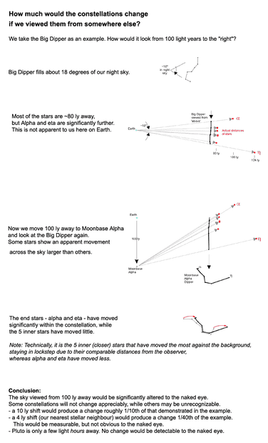

It's "well known" that the shapes and layouts of most of the constellations we can see would be totally different when seen from other parts of the Galaxy

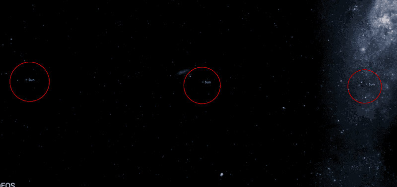

I did the simulation. Three stars in a row, initial 1 light year separation, zero initial velocity.... exciting part 4:30... system lasts about 2.5 million years.
Should I be seeing three stars? I can only see two (apart from the wallpaper behind the action). If they have zero velocity then they will be attracted to each other and, as there is no Angular Momentum, they will collide. They only need a small amount of tangential velocity component to take up a mutual orbit without colliding. One interesting thing about gravity is that inverse square law which still works over the light years but the tiny forces over those distances still get things moving mutually. And what's a couple of million years when we're dealing with more than 30 Billion years since the start.
However, with respect, this is nothing like the simulation I posted. There is no wallpaper on that display. Any mass of gas and dust will have a net angular momentum and that will be conserved throughout the life of the object(s). The simulation (the one I posted) takes a huge number of particles with random velocities and plots the way they will interact. Stars are formed as gravitational potential energy transfers into KE and then thermal energy etc. etc. As I don't know the spacings or velocities (I guess I could find out) then I don't know whether that line of stars in Pleaides is actually a 'thread' of stars. I was rather hoping that someone on PF

OK I see them now. Problem is that, in the video, you very soon zoom the left one out of the picture and that's when I was looking. But my comment stands. Your initial conditions doom them to collision and that's not we observe. There would be no binary stars if they started off that way. And, of course, the reference frame for 'zero angular momentum' is questionable. IS there, in fact, such a frame in the Universe?
