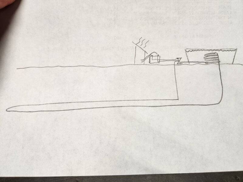

Looking for help calculating heat transfer for PEX ground loop project
In summary, a solar panel with battery to power a circulation pump will be needed to prevent livestock water troughs from freezing. The system will need to be arranged so that rain can clean the panel surface, then run into the trough.
mcantrell71
TL;DR Summary
hydronic heat transfer calcs ??
Looking to build a suitable closed loop water (probably glycol mix) circulation system to prevent livestock water troughs from freezing. I assume that I need to calculate how much heat loss is predicted from the water tank in ambient air (varies, but assume worst case), then what length of heat transfer pipe will be required to be buried in stable ground temp (55 degrees?) to supply the necessary Btu's. The plan is to have a solar panel with battery to power circulation pump.
1/2" PEX. 0.675" OD, 0.070" wall
ground temp - 55 F
ambient - 0F
100 gallon trough uninsulated (for calculations)
0.5 - 1.0 gallon/min pump
THANKS FOR ANY INSIGHTS!!
Start by finding the lowest air temperature at which it needs to not freeze. Then calculate the heat loss from the trough at that temperature, then recalculate assuming insulation around the sides and under the bottom. If you can teach the livestock to poke their noses down through floating balls, calculate again with floating balls. Calculate heat loss assuming 32 deg F water in the trough. That heat loss is how much heat your system needs to supply.
Find the ground temperature in your area. The water temperature in the circulating loop will be roughly halfway between the ground temperature and the 32 degree trough water temperature. From the heat loss calculated above, and the temperature difference between trough water and circulating loop water, calculate the minimum flow rate.
Then search ground source heat pump. Look at the various methods of thermally connecting to the ground. Choose one. The easiest way to size the ground loop is to find the sizes of the ground loops for different size heat pumps, then interpolate based on your calculated heat loss.

I'm not sure I follow this. The solar panel is a PV panel to power the circulation pump for the ground loop. The trough has to remain open for animals to drink.

Thank you for the explanation. What I don't know how to do is run the calculations. I know it is not simple
I did NOT suggest you put a lid made of PV panels on the tank.
On clear nights, the temperature of the sky above can be between -40 °C and -60 °C. That is why the water surface freezes quickly with a clear sky above. You need a roof above the tank to act as an insulator at the local air temperature. Obviously, it must not obstruct the animals and the panels must also be out of reach of the animals that might obstruct or chew on them.
In post #1, you show the panels as being mounted up high, away from the trough. Once you think about it, you will realise that if the panels are mounted above the trough, they can do the same thing as a roof.
Indeed, if you build a simple roof, you may find that the trough does not freeze, so you do not need the PV panels, pump or thermal transfer plumbing. Maybe all you need is an evergreen tree, protected from the animals, with foliage above the trough to hide it from the cold sky above.

I am still confused. When you say "roof", are you implying that it can be any height above the water surface (vs. a lid covering the tank)? A tank full of water in the barn (with a full roof overhead) freezes just as quickly as one outside.

That is a complicated question to answer. It's not a one-line computation...and then, its only half of the story because you need to get the heat into the system with another coil. A completely different set of computations.
The answer to your question is that depends on the working fluid, the thickness and material of the pipe, its length, diameter, to name just a few things.

The calcs for this aren't particularly difficult. The real problem is how to size the ground loop. Different soil and groundwater conditions make it impossible to be very precise - you'll need to miss on the high side. The suggestion to find out what commonly works in your area is a good one - it will give you a place to start.
You said that 1500W did the job. Assuming that:
Warning - Round numbers:
1500W is equivalent to about 5000 BTU/HR or about 0.4 Tons. Assuming a good enough heat exchanger in the trough, you'll need about 42F water at 1 GPM. If you can get the water warmer, you can use a smaller HeatX.
One of the issues with ground loops can be geology. In addition to cooling the ground immediately around your pipes, you may be depleting an isolated pool of heat (longer term) - the system performance can decay over years.
Likes Lnewqban
  • #33
They are making their own heat exchanger out of run of PEX tubing from scratch. The performance characteristic need to be evaluated. Its not nearly as simple a problem as being implied by
$$q = \dot m c_p \Delta T $$
Dissapating 1500W If you wanted to run a 1 gpm pump bringing the flow in at 42 F it leaves at 32.8 F if the length of that PEX tube (of that spec) in the tank (32 F) is approximately 230 ft.
Polyethylene (PEX) is an abysmal thermal conductor, as are most plastics in general.
If you think that is bad the ground side loop to bring it back to 42 F from 32.8F would undoubtedly make that look like a baby coil...
