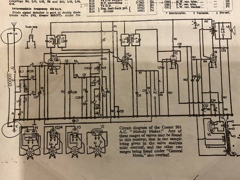

For interest, here is the circuit diagram of the radio. I’ve circled the relevant connections, which are made to L1, the internal frame aerial, in the absence of an external one:
Regarding a coax feeder, I’ve got some idea of impedance matching, but I don’t suppose there’s a hope of working out the input impedance of this setup?
I also have a ‘series set’ style receiver, a Bush DAC90A, which picks up a lot of SMPS noise. Would it be worth posting a schematic here, in case I can somehow connect in a mini whip, or perhaps start a separate thread?
Impedance matching does not matter in this case. These receivers tend to have an input impedance of say 500 Ohms, to suit a wire antenna. Just use a coaxial cable to connect to a remote antenna.
