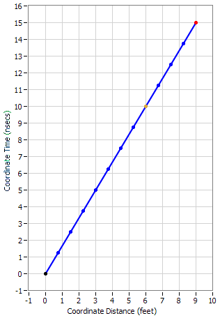

So for an event at t = 15, x = 9, in system K, where system K' is traveling along the x-axis at velocity 0.6c, γ = 1.25. (Origin of system K, (t,x,y,z), (0,0,0,0); Origin of system K', (10, 6,0,0))
Then x' = γ(x' - vt) = 1.25( 9 - (0.6)15) = 0
where if the term vt were to represent the difference in the x coordinates for the origins
Then x' = γ(x' - vt) would give: x' = 1.25(9 - (0.6)10) = (1.25)3 = 4.25 or γ3
Explain, please...
No, this is not the same event as that you just computed the LT for. The Lorentz transformations in standard form relate the coordinates for two systems with coinciding origins. The origin of K' is at (0,0,0,0).
But if they have the same origin then the '-vt' term is meaningless as it will always be 0.
With collocated origins, x' = γx, surely? What could vt represent here? The relative velocity of K' multiplied by the time coordinate? Which is surely the distance that K' has traveled in time t from the point of separation, their common origin!
One has to set vt to 0 with common origins or substituting x for vt (because x does equal vt) one gets x' = γ(x - x)
Please, please, please...
If I am wrong then shew me what other value vt has...
No, this is the location of the spatial origin of K', which is a world line and not an event. It may have a different t' coordinate and is described by (t',x',y',z') = (t',0,0,0).
No, definitely not. The time coordinate is not equal to zero for all events. This is only true for events that occur at time t = 0. It is a very particular event (in the given coordinate system), namely an event which is simultaneous with the origin in K. The Lorentz transformation tell you:
x' = γ(x-vt/c)
and there is no a priori reason to think that a given event would have time coordinate t = 0 unless otherwise stated. You definitely cannot describe all of Minkowski space with t = 0. In the transformation, x is the position of any event in space-time and t is the time of said event, both in the system K, it may occur before or after the origin. The only thing that is particular for the given Lorentz transformation is the velocity v which is the velocity between two objects when one of them is at rest in K and the other in K'. You can check this by setting x' = 0, which is the spatial origin of K'. This gives you x = vt and thus an observer at rest in K' at x'=0 is traveling with velocity v in K.
vt can have any value, this depends only on when the event you are transforming occurs in K.

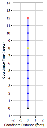

This is a simple problem that we can work out.
Excellent. You used the LT to calculate the x' coordinate in system K'.
Explain, please...
Explain what? You already correctly calculated x', why are you dissecting the formula? Instead of doing whatever it is you are doing, you should instead calculate t', like this:
t' = γ(t' - vx) = 1.25( 15 - (0.6)9) = 1.25( 15 - 5.4) = 1.25( 9.6) = 12
Problem solved. Is that so difficult either in concept or in enactment?
For this event t'=12, x'=0

OK. I did not make it clear, but when I wrote:
that I was referring to the coordinates of the Origin of 0' in the reference frame of system K.
So that starting from the origin of 0, that is (0,0,0,0), system K' (it's origin specifically) has traveled along the common x-axis for 10 seconds at 0.6c or 6 light seconds, arriving at (10,6,0,0). Which are the coordinates for the event at (10,6,0,0) in frame K, which is the same event that has coordinates (10,6,0,0) in frame K'.
The coordinates of the origin of system K' in system K are x' = γ(x - vt) = 1.25(6 - 10(0.6) = 0, and t' = 1.25(10 - 6(0.6)) = 8
while the coordinates after another 5 seconds when t = 15, x = 9 would be, x' = 1.25(9 - 15(0.6)) = 0 and t' = 1.25(15 - 9(0.6)) = 12
So the value calculated for the time coordinate, t' is fine = t/γ, whereas the x' coordinate always comes out at 0.
But it still seems reasonable to me that the x' coordinate is a function of the x coordinate γx, LESS the displacement of the O' frame when x' = 0.
