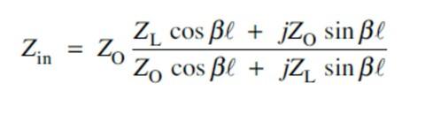

A 50 Ω lossless transmission line of length 0.4λ is terminated in a load of (40 + j30) Ω. Determine, using the equation given below, the input impedance to the line.
Zo= 50
Zl= 50∠36.87 or 40+j30
βι= 144° (this is known due to a previous question)
Zin= 50 x ((50∠36.87)*cos144°) + (j50*sin144°)/(50*cos144°) + ((j50∠36.87)*sin144°
=50 x (-40.5∠36.87 + j29.4)/(-40.5 + j29.4∠36.87)

This question has been done on other threads before but I couldn't make sense of them.
Can anyone tell me why I've arrived back at the Load impedance? and where am I supposed to go from here?

The 144° is from 0.4λ, correct?
Also, notice how the magnitude of the load and line compare. What would happen if they were different?
Hi, yes that's where I got the 144° from.
My heads honestly scrambled on this, if they were different there would have been something between the two on the line? i.e resistance?

? You already went where you were supposed to go, assuming your math is correct.
