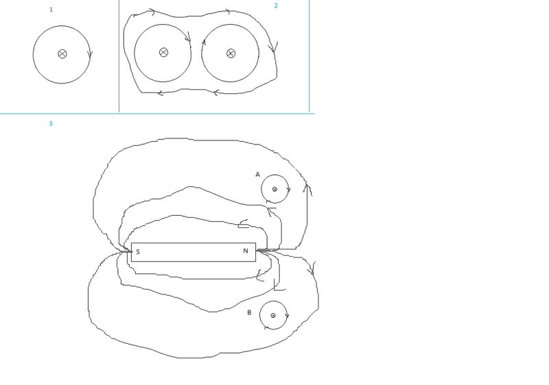

This is not a homework Problem.Just a doubt.
The cross represents current-IN.
1-Magnetic field lines are produced in clockwise direction when current is going IN.
2-When wires carry currents IN,they form clockwise magnetic fields.So the magnetic fields of two wires join,forming a loop which attracts them(This is what my teacher said)
3-What happens in the case of a magnet?It won't form a "loop" because the field direction of the outer magnetic field of the magnet is opposite to that of the wire(A).But the inner field is in the same direction.

That description from your teacher was a bit glib and incomplete. Hopefully you will study the forces on wire in an external magnetic field very soon.
A wire carrying a current does experience a force in the field of a magnet.
i.e. wire A will be deflected (roughly) upwards and to the right, wire B will be deflected upwards and to the left.
For two current carrying wires, consider the force on one current due to the field of the other wire: you'll see it follows the same rules.
http://hyperphysics.phy-astr.gsu.edu/hbase/magnetic/forwir2.html
