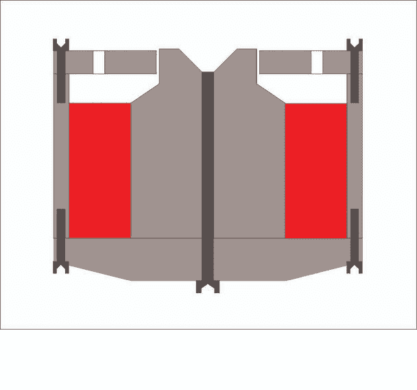

I found the material I was looking for , it is called hiperco 50 , but there are problems .
it is expensive and difficult to machine.
so i have another question for you .
in the attachment you can see , in section , how the magnetic motor of a field coil loudspeaker is made .
you see a central body, an empty red space where the copper wire winding and a double outer ring are placed.
the question is the following:
can I build the central body with hiperco to have maximum magnetic saturation and the outer ring in another material but with very high magnetic permeability? . how does the magnetic flux intensity change? .
then I don't know if in the long term it is possible to create oxidation on the contact surface between two different metals.
I see no point in having such thick magnetic material for your field coil, when the space could be taken by copper magnet wire.
The cross-section of the magnetic circuit should be constant along the magnetic path, so that if saturation occurs, it occurs everywhere at the same time.
I didn't understand the meaning of some words in your answer.
what do you mean by the following sentence? :
"I see no point in having such thick magnetic material for your field coil, when the space could be taken by copper magnet wire."
would you say that you can use less metal and more wire wrapped in copper?
Do you have experience building this type of speaker?
I have experience with that type of electromagnet, but not with ones as small as that.
Maybe prototype by replacing only the magnet on a standard speaker. Will you use a commercial product for the voice coil and for the cone and suspension?
You should start by specifying the voice coil dimensions, the radii and the axial length of the winding, as everything will grow from that by geometry.
Maintain the same section of magnetic path throughout the magnetic circuit, taking into account the circumference at different radii. Avoid sharp internal corners.
Baluncore said:
specifying the dimensions of the voice coil, the radii and the axial length of the winding
first i need to get the answers i need .
my idea is to use a full cylinder with hiperco 50 only for the central core wrapped in copper coils.
this, because hiperco is expensive and difficult to work mechanically, with it I can get the maximum magnetic saturation with less copper coils and less electric current. then instead use another material for the outer O-ring. I had thought of mu-metal because it is easily machined on the lathe, costs less and has a very high magnetic permeability, then I discovered that its magnetic saturation is very low. So my question is the following: which material can I use for the outer ring ?
maybe steel with low carbon content?. if I do this, however, I get a lower general magnetic saturation. Maybe it's better to use a material that has a lower magnetic saturation but greater permeability than hiperco? .
I await the correct answers from you.
