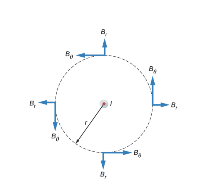

Use Ampère’s law to calculate the magnetic field due to a steady current I in an infinitely long, thin, straight wire as shown in the image
##\oint_{line} B\cdot dl##
Can someone explain how there can be a radial magnetic field? I thought the magnetic field was always tangent to the circle using the right hand rule where you wrap your fingers around the current and point your thumb in the direction of the current.
And so what is the value of ##B_r## ?

Don't interpret the picture as giving the answer. The picture is testing your understanding. You have to figure out what the field looks like by using Ampère’s law.
I strongly suspect the idea is not to compute ##B_r## from Ampere’s law but to use symmetry arguments to deduce things about it. The real question is: how can you use Ampere’s law and symmetry arguments to find the magnetic field?

If there is no ##B_r## then your task is to show that using Ampères law and symmetry arguments.
Likes Orodruin and Delta2
As an aside, but a highly relevant one:
Figures should be and are often drawn in a general fashion. There is no real need for the figure to necessarily accurately depict the result. For example, you can draw a free-body diagram with a force pointing in a certain direction and then consider the equilibrium equations based on that. If the force then turns out to be negative then it points in the opposite direction. If it turns out to be zero, then it is zero. It is the same thing here (although the problem author has cut you some slack by indicating that ##B_r## and ##B_\theta## have constant magnitude).
The right-hand rule that you are referring to is the result of Ampere’s law. You are supposed to show this here (and you may use symmetry arguments to help you along).

The problem with using the integral form to get at the radial component is that any vector field on the form ##f(r)\vec e_r## is conservative and therefore contributes a net zero to any closed loop integral.
What should be used are the transformation properties of the magnetic field and current source.

Did you read the caption on the figure in the textbook? (bolding mine)
Figure 12.15 The possible components of the magnetic field B due to a current I, which is directed out of the page. The radial component is zero because the angle between the magnetic field and the path is at a right angle.​

The book makes a straightforward argument from symmetry and Gauss's law for magnetic fields.
There seems to be some context missing here. What path?

The circular one depicted in the figure @annamal posted in the first post. Apparently, I didn't read that sentence very carefully (I stopped at "radial component is zero"); it looks like they left a few words out.

I assume they mean the radial contribution to the line integral is zero. The fact that the dot product is zero does not directly imply that the radial field is zero. This is badly stated. What is the text?

Yeah, that's what I realized when I read the sentence more carefully after first posting it. In the discussion below the figure in the OpenStax textbook, it's explained how to deduce the radial component vanishes.
