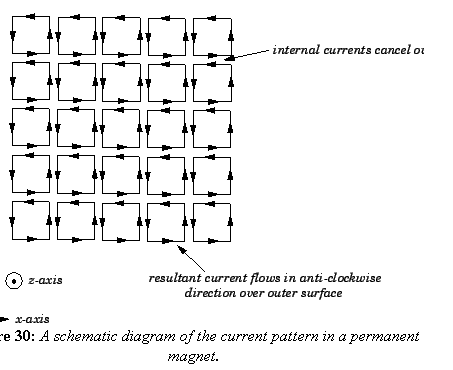

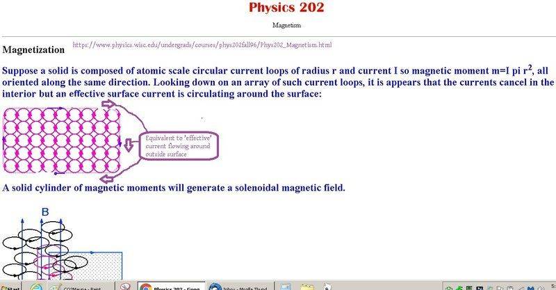

In applying Biot-Savart, you also need to apply it to the magnetic surface currents from the magnetized iron. This problem with the air-gap is somewhat unique and the equation ## \oint H \cdot dl=N I ## is used. Let me give you a "link" to this problem which previously appeared on Physics Forums: (need to look for it=should have it momentarily=here it is: https://www.physicsforums.com/threads/absolute-value-of-magnetization.915111/ See also the "link" in post #2 of this "link" that has the Feynman lectures derivation of it. ## \\ ## For a problem that treats the magnetic surface currents, see https://www.physicsforums.com/threads/magnetic-field-of-a-ferromagnetic-cylinder.863066/

The magnetic surface currents are present even in the static case, and occur also in a permanent magnet. The magnetic field for any magnet can be computed from Biot-Savart (or Ampere's law) if the magnetization ## \vec{M} ## is known, so that the surface currents can be computed. (In complete detail, the magnetic current density ## \vec{J}_m=\frac{\nabla \times \vec{M}}{\mu_o} ##. The result is that there are surface currents at boundaries given by surface current per unit length ## \vec{K}_m=\frac{\vec{M} \times \hat{n}}{\mu_o} ##, but there can also be magnetic current densities in the bulk material in regions of non-uniform ## \vec{M} ##). ## \\ ## For a somewhat detailed example of the magnetic surface currents, see https://www.physicsforums.com/threads/magnetic-field-of-a-ferromagnetic-cylinder.863066/
And just one additional comment: If you do attempt a mathematical solution of this magnetic core with a gap problem using a model that assumes a linear response of the material so that you can write ## M=\mu_o \chi_m H= \chi_m' B ##, for some ## \chi_m ## and a related ## \chi_m' ##, and computed the magnetic surface currents from the magnetization, and then used Biot-Savart to find the magnetic field, it would be an extremely complex calculation, in the sense that you would need to guess a magnetic field solution ## B ## everywhere which would cause magnetization ## M ## that would likely be somewhat non-uniform, and the ## B ## that was computed from the magnetic currents that arose from the magnetization ## M ## would need to be equal to the "guess" for ## B ## that was proposed. If the original guess was a rather good one, the actual magnetization ## M ## and the actual ## B ## could be ultimately determined in an iterative and self-consistent manner. This approach is, at best, still a very difficult one. ## \\ ## The method that is normally used for this problem,[Edit: "magnetic circuit theory"], involves using a modified form of ampere's law ## \oint H \cdot dl=NI ##, and assuming ## H ## is constant throughout each material, and is ## H_1 ## in the air gap, and ## H_2 ## in the iron. This is clearly using an approximation to arrive at the answer, but it gets an answer that has been verified repeatedly with experimentation that has shown it to be reasonably accurate, so it is considered the accepted way of solving this problem. ## \\ ## The alternative method of Biot-Savart and magnetic surface currents would likely get a similar answer with a very lengthy and cumbersome process of calculation, but in general, this problem of the magnetic transformer with an air gap simply is not done in this manner. ## \\ ## [Edit: There is also a magnetic "pole" method of doing magnetostatic calculations, that is equivalent to the surface current method, but sometimes gets to the answer a little quicker. In any case, I don't see any easy way of getting any quick results with the transformer with an air gap problem by using these alternative techniques].

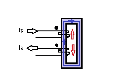

Charles - i got past my confusion on dots and flux direction...
I am one of the less capable mathematicians here on PF
so kindly excuse the less-than-academic nature of this post.
I will describe the thought steps i use to get a mental picture of what's going on in a transformer. From that i can figure out a formula to approach most any problem i encounter.
Charles Link said:
Without any load=no secondary current, the transformer will develop a voltage that is a result of E=−fracdΦdtE=−fracdΦdt \mathcal{E}=-frac{d \Phi}{dt} , and the magnetic flux ϕϕ \phi is in phase with the primary current. This means the voltage on the primary coil at zero load on the secondary will be 90 degrees out of phase with the current from the primary. Now we are going to assume here that we are driving the primary coil with a voltage source that can deliver whatever current it needs to to maintain the voltage. \\
To what degree of precision do we wish to describe the transformer ?
Your words above describe an ideal or near ideal transformer quite well. That would be one with zero resistance in its primary winding assuring 90 degrees between primary voltage and current.
A truly ideal transformer would have infinite inductance hence zero magnetizing current but we won't push our analysis to that extreme, just it's a point to be aware of.
Energy lost in the core looks like resistance in parallel , but for right now let's assume it's little enough energy we can ignore it. In a good transformer that's not far from the truth..
SO yes, with sinewave excitation constant voltage means constant flux. I use volts per turn as a measure of flux.
Charles Link said:
Let's assume we now attach a small resistor to the secondary,(a significant load). There will be current in the secondary that is in phase with the voltage that is generated in the primary and secondary from Faraday's law. This secondary current must be necessarily 90 degrees out of phase from the zero load current of the primary. In addition, the equations that we have suggest there must necessarily be an increased current in the primary. This new current must satisfy NpIp=NsIsNpIp=NsIs N_p I_p=N_s I_s . It would appear that this primary current must be in phase with the secondary current, and thereby will be in phase with the primary voltage. That would be expected from power considerations=this primary current needs to be in phase with the primary voltage, and not 90 degrees out of phase. \\
I think in terms of MMF's and let flux be MMF/Reluctance(of magnetic path). Remember units of MMF is amp-turns .
And being really a plodder i think in small simple steps.
Magnetizing current will be whatever amp-turns are required to push enough flux around the core to make a counter-emf equal to applied voltage.
A low reluctance core , ie good steel with no air gap will require very little MMF hence little magnetizing current.
A core with an air gap like you drew in first post will need a lot more amp turns to push the necessary flux through that gap. Magnetizing current will be higher.
So let's stick with a gapless core.Now let secondary current flow. That current produces MMF that opposes primary MMF.
So primary current must change to restore flux and counter-emf to match the voltage applied to primary windings. But how does it change ?
Primary and secondary voltage must be in phase with one another because they're both the derivative of the same flux.
Secondary current has to be in phase with secondary voltage because the load is defined, for this thought experiment, as resistive.
So secondary current makes MMF that's out of phase with flux . Secondary current and MMF are both in phase with derivative of flux..
Hmm. Plodding along here,
Flux has to remain constant , defined by the applied voltage which we are holding constant for this thought experiment.
And since flux is ∑MMF's/ Reluctance and reluctance is constant
that means primary current must change to make a MMF that's equal and opposite to secondary MMF. Else sum of MMF's won't equal magnetizing MMF.
Well, MMF's are directly proportional to current, no derivative,
so primary current will pick up a component that's in phase with derivative of flux to balance the one from secondary current.Now Faraday's Law acquires a minus sign when we incorporate Lenz's Law and you'll often see e = -NdΦ/dt and that can get confusing.

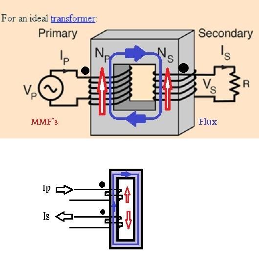

Add to that, transformers are usually drawn with flux going up one leg and down the other.
That's why we use the "Dot" convention. Dotted terminals will all move positive together, ie they're in phase.

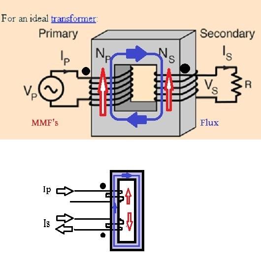

But I resort to pictures. Snip from Hyperphysics, i don't think they mind so long as i credit them and don't cause lots of traffic there...
In top image
i added dots and arrows for flux and mmf.
Dot convention = dotted terminals will be positive at same instant. That's how you get phasing right.
Observe current ENTERS primary's dotted terminal but LEAVES secondary's dotted terminal. By right hand rule that gives upward MMF's in both windings .
Secondary MMF is Counterclockwise opposing Clockwise primary MMF . Lenz's law at work.In Bottom image
I just moved secondary over to same side of core as primary . That makes one MMF point up and one down. Look carefully, i was rigorous to preserve winding directions relative to flux.
That helps some folks visualize right hand rule . It helps me remember that, in most training materials, the windings are drawn encircling the flux in opposite directions, Viewed from the top, primary is wound CCW and secondary is CW. It might be clearer drawn this way with primary and secondary both wound same direction..…
That removes the confusion factor of winding direction. I need things simple.
All that having been said ,

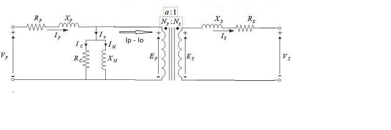

now i want to point you toward Wikipedia's electrical model of a transformer . It's a pretty good thought tool. It's at https://en.wikipedia.org/wiki/Transformer
Rp and Xp repesent primary winding's leakage inductance and resistance.
Rc represents energy loss in the core due to eddycurrents, hysteresis , magnetorestriction ...
The transformer in the middle is ideal - zero magnetizing current , infinite inductance.
Xm represents the actual finite mutual inductance of the transformer.
Io is sum magnetizing current that makes flux and current that goes into core losses, ie heating the iron.
Rs and Xs are resistance and leakage inductance of the secondary winding.

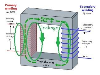

Leakage inductance is present because of flux that doesn't couple both windings..
From the Wiki transformer page:
i just drew in a few loops of leakage flux..
I hope the above is of help to you.

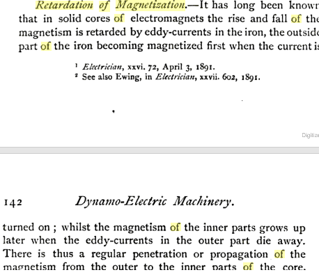

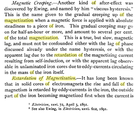

Are these laminations a necessity, and how effective are they in minimizing eddy currents?
They are indeed necessary.
Magnetization proceeds from the periphery toward the center of a piece of iron, because eddy currents oppose the change in flux per Lenz.
A solid unlaminated core, above some frequency, might as well not have any iron in the center.
Laminations impede eddy currents allowing your core to use its whole cross section to conduct flux. Analogous to skin effect in wires carrying current.

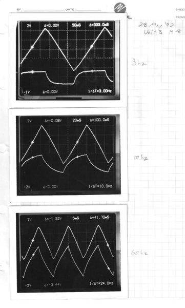

I once measured an inductor with a core made of unlaminated 400 series stainless steel bar stock. Above 3 hz it was really not a good inductor.
here is its response to triangle wave current at 3hz, 10 hz, and 60 hz.
Triangle wave has constant di/dt so should produce square wave voltage. Sinewave only gives phase shift, triangle wave makes the effect a lot more obvious to the eye
Observe voltage is di/dt only at low frequency
That system ran at 60 hz. It had terrible drift with temperature because resistivity of steel is a strong function of temperature, and eddy currents follow it.
