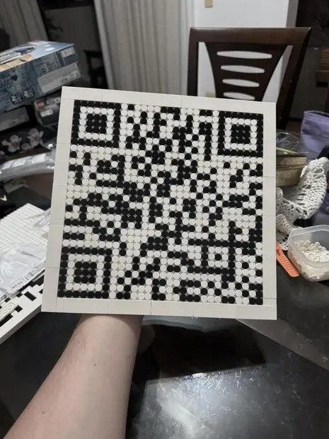

Here's one made out of LEGO - I found on Google (It goes to something called Quasar.)
LEGO has been done, so I wanted to make something that befits a nice living room. I had planned to make one out of seed beads.

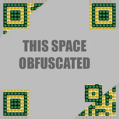

This is my mocked up Photoshopped prototype to test the colurs and contrast (obscured so I don't reveal my network creds to the world):
I assumed that camera s/w is smart enough to detect a QR code in widely adverse conditions, but my experiments are revealing that that is not the case. It could not read the above image. (It is quite new. Samsung A14 w/ Android)

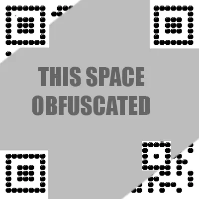

Here is the same pattern in black and white:
No joy. My camera did not recognize it.
The only difference between this and the generates one is that mine uses round dots - which are allowed, by the way - but apparently they can't have any gap between them.

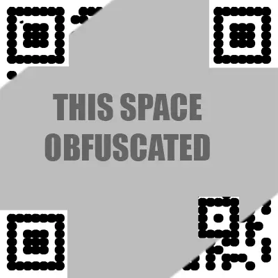

Even this is too much whitespace:

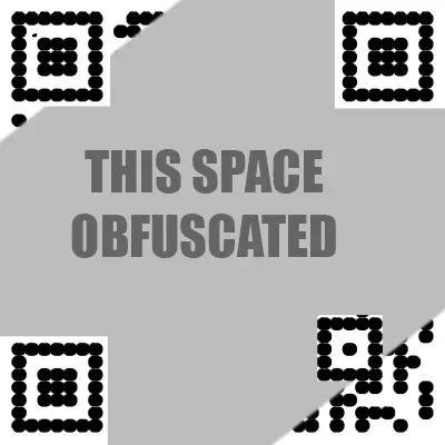

My phone won't register this as a QR code until the black dots are touching each other:
Which kind of puts the kibosh on the whole project. There's just no way to create a real-world QR code plaque out of objects that has zero gap between them. Besides, even if it could be done, it would kind of defeat the purpose, since they wouldn't be distinguishable to the eye either - ruining the whole effect.

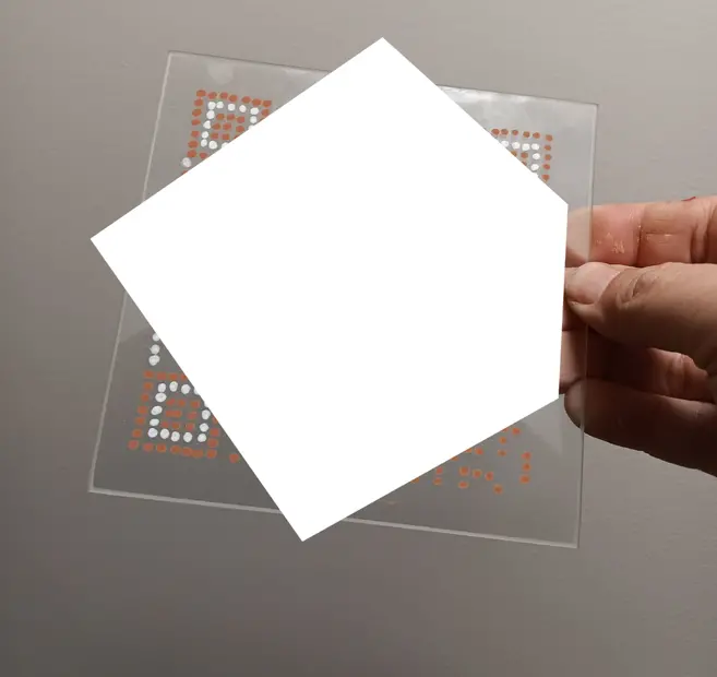

I also made a much faster experimental prototype by painting the dots on a piece of glass, which - if it had worked - would have been very elegant (though a bit inconvenient to use, since you have to get the lighting just right and avoid any shadows).
Anyway, it didn't work.

LEGO has a resolution of 8.5mm (1/3 inch) per pixel. Which makes a LEGO QR code a whopping 11 inches on a side.
I wanted something more elegant. Less than 5 inches, ideally.
