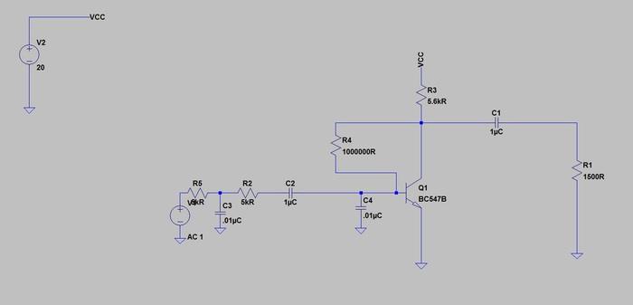

Can't you just use something really simple like this under all circumstances?
That will not be linear. Look up "emitter follower" or "source follower". That would be simplest buffer (with no voltage gain). If you need voltage gain, then you essentially need to build an amplifier. The characteristics of the amplifier will depend on what you need to accomplish.
Your circuit seems to be an amplifier rather than a filter. In addition it will give 180º (ish) phase shift. And as meBigGuy pointed out it's non-linear. (The phase shift is 180º for most of its bandwidth, but drifts near the knee frequency.)

Please post the schematic of your prototype BJT filter with your required specifications. We can then give you some good solutions to the output impedance problem.
Alright, thanks. Between C1 and R1 is where the output will be coming from.

The circuit I posted above is a bandpass filter with a pretty reasonable gain in the midband. There's 40db/decade rolloff either side of the midband and the cut off frequencies are at about 100hz and 10khz.

The Q1 amplifier with primitive bias will be a disaster.
Gain will be signal amplitude dependent.
There will be harmonic generation due to the non-linearity of the Vbe junction.

You don't need to worry about that. I've ensured that the BJT is staying within the active region throughout the complete cycle of the AC signal by doing some fairly drawn out small signal analysis.

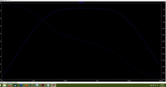

I graphed the voltage drop across the Vce junction in the circuit you uploaded and you can see that it never falls into saturation, so what are your concerns exactly?
Also, I can't see anything wrong with this bode plot.
There are a number of problems with such rudimentary biassing. Okay, you have tweeked it so it works just fine right now, but ...
things will change as temperature drifts, but worse is when that transistor burns out (for some mysterious reason that I cannot always pin down) the transistor you replace it with will be quite different in gain and the circuit will need to be checked and tweeked all over again. That's why a more stable arrangement is always used.
Do you need this filter to continue to work reliably for any length of time?
What is the vertical scale dB/div ?
fixed the graph

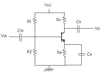

I agree with the others that your circuit is a disaster. It will have high distortion and the gain will vary with temperature, age, and from transistor to transistor.
It is nothing like what is used inside an opamp.
A typical discrete circuit with stable gain and bias would be
You will find no common emitter 1 transistor amplifier circuit without two bias resistors and an Re

How come you should use two bias resistors? Also, isn't having an Re only beneficial if you're going to have a non stable/unclean VCC?
An emitter resistor Re (providing negative feedback) has the following advantages:
* DC bias point more stable against temperature changes and BJT parameter tolerances (beta)
* Lowering of signal gain (advantage?)
* Signal gain less sensitive to BJT parameter tolerances
* Reduction of signal distortions (lower THD)
* Drastic increase of input resistance
* Bandwidth increase
Finally, Re provides negative VOLTAGE feedback - therefore, this feedback scheme works best if the input biasing is realized using a voltage divider that can deliver a "stiff" voltage (as stiff as possible). However, due to some other constraints (power consumption, input resistance) the voltage divider must not be too low-resistive. As acommon trade-off the current through the base divider is set to a value of app. 10*Ibase.

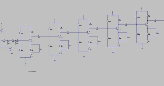

Alright, I changed the circuit again to account for the problems that you mentioned. Do you see any problem with implementing this type of filter near the source like this?
Because you have ac-shorted the emitter resistance in both stages the input resustance at the base node as well as the signal gain depends considerably on transistor parameters. Bad design.
( I didn`t check the resistor values!)

Oh, okay. That's something I copied from the image at the top of this page (posted by meBigGuy).
My requirements are that its a band pass filter with a mid band between 100hz-10khz, and 40db/decade attenuation. Gain in the mid band is 400.
The filter part near AC1 is okay though right? That filters out the high frequencies.
