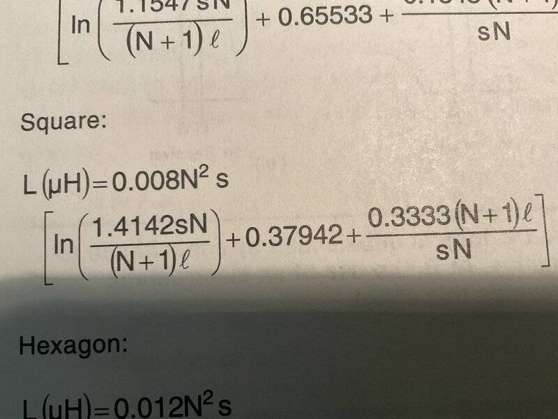

There is an equation on page 5-5 to find the inductance of such a design. I assume I then calculate the inductive reactance at 12MHz, and spec a capacitor to suit, and place across the feed point.

For a single triangular loop, of length 213cm and side 71cm, I get an inductance of ## 2.452 \mu H ##.
This equates to ##X_L=j184.9\Omega## at 12MHz.
Using ##C=\frac {1} {j\omega X_C}##, I get a tuning capacitance of ##72pF##.
Checking backwards, ##F_0 = \frac {1} {2\pi \sqrt{LC}## gives a resonant frequency of 11.9MHz.

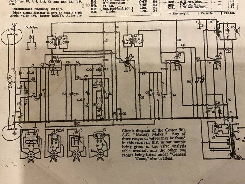

It’s a Cossor 501 transformer-type set. Schematic below, where you can see the frame aerial hooked in to banana jacks ‘A’ and ‘E’. These can be accessed from outside the set, unplugged and substituted for the new aerial.

For a square loop, where N=turns (2), s=side length(26 cm), l=coil length(213 cm):
I get an inductance ##L=1.9245\mu H##
Reactance ##X_L=j\omega L=j145.1\Omega## at 12MHz.
Capacitance ##C=\frac {1} {j\omega X_C} = 91.4pF##
For square multi-turn loops, distributed capacitance is given by $$C(pF)=60S$$ where ##S=side~length (m)##
$$C=60(.26)=15.6pF$$ Which gives ##75.8pF## when subtracted from the result above.

If you dive in and identify volts on the AGC line then you have a fairly reliable (numerical) way of finding a maximum, not relying on your ears, as you tune your capacitor. No need for a signal source as you can use a handy off-air signal.
Does that document, part of which you posted, help to find the AGC part of the circuit?
The full circuit is shown in post #5. The only candidate I could see for AGC, is the horizontal line drawn below the ground line. I expect capacitor C7, connected to ground, sets the time constant.
Likes Guineafowl and sophiecentaur
Cheers. If the OP has a meter and can avoid a shock on a scary valve circuit, it may be useful for him. It would be easy to see whether it works - it should.
That line seems to affect the bias of V1 and V2. My eyes go fuzzy when I look at valve circuits; too many connections!
Yes, the AGC line is via R8 and decoupled by C7. I did a restoration and alignment of this radio a few years ago, so quite happy to open up and probe the AGC line if needed.

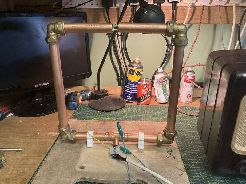

Well, I built a two-turn, shielded loop (no cap yet). Interestingly, it doesn’t seem to do anything - the 10ft or so of coax going to it gets a reasonable signal on its own, through the centre conductor. Disconnecting the shield also makes no difference. Connecting the antenna up doesn’t improve the strength much.
Don't expect a good result until the tuned antenna is independently resonant. Tuning performance will depend on how lightly you can couple the tuned two-loop antenna to the line.

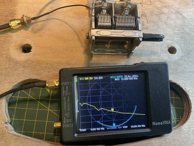

I had a small amount of time to try the nano VNA on the antenna,
Sweeping from 6-18Mhz, in S11 mode, it shows ##\infty## SWR all along, and is acting as an open circuit on the Smith chart.
Changing the sweep to full range (50kHz-900Mhz), there are several dips in the SWR, but all above the 700 MHz mark.
More work needed! Tuning cap yet to arrive.
Hmm, that's not good. Can you upload a sketch of your antenna showing the connections and such?

Without the capacitor, the untuned loop is an inductor.
It will appear to be open circuit at RF.
There may be bumps in the response, due to the capacitance of the cable, transformed by the length and impedance of the transmission line.

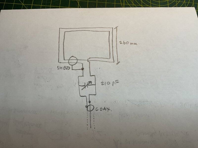

There is a rough sketch in pencil, showing the double loop, and copper pipe shield connected to the left-hand side.
SWR (Yellow), 50/div.
Smith plot in blue.
210pF capacitor plates open.
Sweep from 6-18MHz.
Now with plates closed, presumably 210 pF.
So we appear to be stubbornly skirting the outer circle, where reflection coefficient is 1.
No pencil sketch ?
Please show us a photo of the whole copper loop, so we can see the insulated break at the top.
Ideally, the capacitor should be balanced with two identical gangs, so the chassis can be grounded, with the tuned loops being balanced.
Post #12
Likes Guineafowl, Baluncore and berkeman

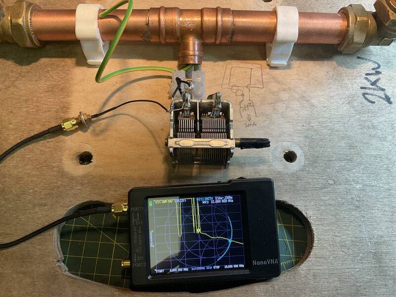

DaveE said:
Indeed. There is also a pencil sketch on the wooden board pictured above, but here’s a better one:
Looking at the top VNA plot, we appear to have a point of resonance somewhere between 6 and 12Mhz, but the real resistance is very high. Could this be due to skin effect at these frequencies?
The conductor diameter is only 2.5mm (0.1”).
Probably not. It is more likely that the asymmetry of the earth is causing the problem.
The mid-point of the two turns should be earthed, not one side. One gang of the capacitor should tune each side of the coil, with the chassis of the two-gang capacitor being earthed. Some form of isolation between the tuned antenna and the coax is needed, such as a 22 pF capacitor from one side capacitor-coil junction, to the coaxial centre conductor.
Here is a schematic for a 2 turn loop antenna with a screen.
Note that the centre of the two loops are connected to the screen and earth.
Likes Guineafowl, Averagesupernova and DaveE
Thanks for taking the time to draw the schematic.
One problem that occurs to me, is that the radio tuning cap I have is not symmetrical. It’s also hard to access the wire loop, now it’s enclosed in the copper pipe.
With that in mind, I made a second loop without the shield, and hooked up as you’ve drawn. The VNA readout from 6-18MHz showed a spiral in the outer third, indicating several points of resonance.
Out of interest, I attached the VNA to the on-board antenna of the radio, and it showed an arc at the ##\infty## side of the plot, much like I had before. This is a 6m loop with 6 turns.
Am I right in thinking that, in order to tighten the spiral response, and so improve the response of the antenna, I need a larger conductor for the loop?

Ahhh. You are measuring the DC resistance somewhere, with a DMM. That can easily be infinite if there's a capacitor in series but that won't be the real part of the impedance at your operating frequency.
The cable used between the analyser and the antenna will rotate the Smith chart diagram due to twice the line transit time, changing the phase. You should recalibrate the analyser, with a short coaxial cable, dedicated to the analyser. Use the analyser as an S11 reflectometer.
At resonance, the antenna reactance will change sign, so it will cross zero. That will place the antenna resonance somewhere along the horizontal axis of the Smith chart on the analyser. Ideally, I would expect it to be at the infinite R, but just where on that axis will depend on the matching transformer and radiation resistance of the antenna. Maybe you should practice with a lumped LC parallel resonant circuit first, to see how it performs.

I’ve had a chance to build the loop as per post #25 by @Baluncore using twinax cable. Even in the daytime, it was receiving some pretty strong overseas signals. Will try later on tonight. One small problem is, the stations don’t seem to announce what/where they are.
  • #39

6-18 MHz. I’ve found huge lists of SW transmissions, all at different time slots, and it’s quite difficult to work out what’s what with the time differences. I’ll make a rotary stand for the antenna, now I know it works.
Looking at your diagram in post #25, would you simply connect a twisted pair between that and the radio antenna jacks?
I’ve hooked up the VNA, and it shows a resonance around 12 MHz if I tune the cap just right, but it’s not very good (SWR 4 at best) and essentially infinite SWR everywhere else. Given the antenna works pretty well, I assume the tuning isn’t that critical, and there’s some interaction between the radio’s tuning cap and the feedline that isn’t being taken into account.
You could use a twisted pair, but if the radio antenna socket was balanced, I would duplicate the coupling capacitor and take the differential signal from the two windings.
You could try reducing the value of the 22 pF coupling capacitor.
To get good Q and tuning of the antenna, you must not overload the tuned antenna circuit with the feedline to the receiver.

As far as I can see from the schematic in post #5, the radio antenna socket is unbalanced, having the lower side connected to mains-earth-ground. I assume I should therefore keep the single 22 pF cap?
In the building of this antenna, I’ve completely missed the ‘ground’ connection at the bottom of the diagram in post #25. Does this mean an extra flying lead to mains-earth-ground?
The design in #25 is balanced (in theory, at least) so there should be no spurious current to flow down any other 'earth lead' to upset the sensitivity pattern or effects from local E fields. Equal and opposite currents flow in the inner and inside the screen of the coax with none on the outside. I don't know why that ∇ symbol is on the diagram; I'd expect the antenna to be insulated from the mast / 'earth', ideally.

The 22 pF isolates the one-sided cable capacitance from the dual gang tuning capacitor. You may benefit by reducing the value, which will reduce the coupling to the coax, and so increase the Q of the antenna tuning.
The earth is there to reduce the pickup of local radio noise from the structure of the building, hull of the boat, or the fuselage of the aircraft.
Static discharge from rain, lightning strikes, or St. Elmo's fire, need to go directly to ground, without following the coax to the radio room.
When you connect the antenna to a receiver, your hand will contact the outside of the coax through the connector. If the antenna is not earthed, someone could receive a shock in the radio room.
During testing, the antenna will be sheltered, so the outside of the coaxial cable braid will do the job for you, while the signal propagates on the inside.
The ground symbol connects the screen and the centre-tap of the two loops to the structure of the 'mast'. That parallels the practice of grounding the boom of a Yagi antenna, and the centre of the dipole element. That ground is there to protect the coaxial cable insulation and the operator, from Thor at his best, on a Thursday.
