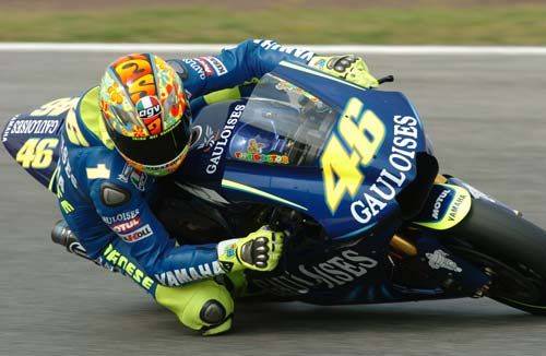

Debozo said:
So what's goin on.
You are making this far more complicated than it is, and then trying to derive a general rule from a system that you have improperly defined. That's what's going on. Look at the picture of the motorcycle racer that DH posted. His front tire is turned in the direction of his turn and he is leaning INTO the turn with his body weight helping him maintain the angle through the turn.
He initiated the turn by counter-steering at the end of the straightaway, which threw his center of gravity to the right, then as he got to the right turn angle, he steered to the right. Steering hard toward the right while applying throttle helps the rider get through a tight right turn at higher speed, BUT it also exerts a force that wants to force the bike upright, so the rider shifts his body-weight to the inside of the turn to counteract that. If he did not shift his weight, the bike would tend to right itself due do the hard steering, and he would drive off the outside of the curve.
There is nothing mysterious about the physics of riding bicycles or motorcycles. Calculating all the forces involved is a complex job, but the physics is well-understood.
