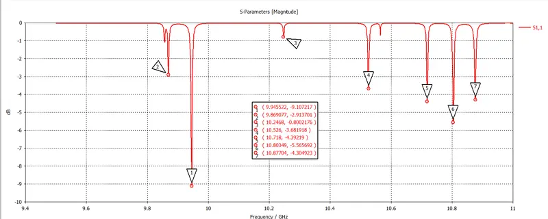

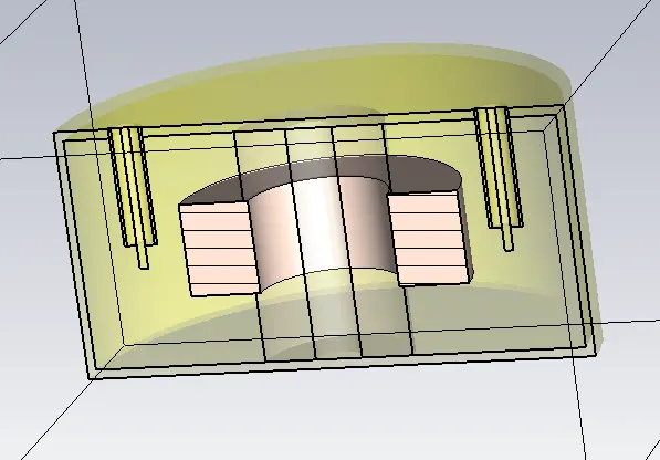

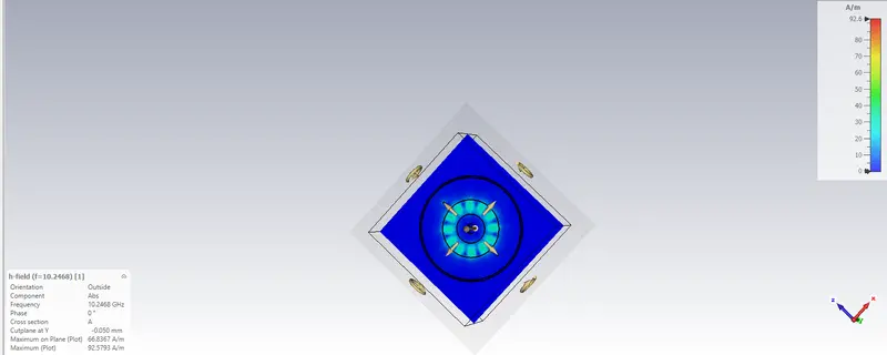

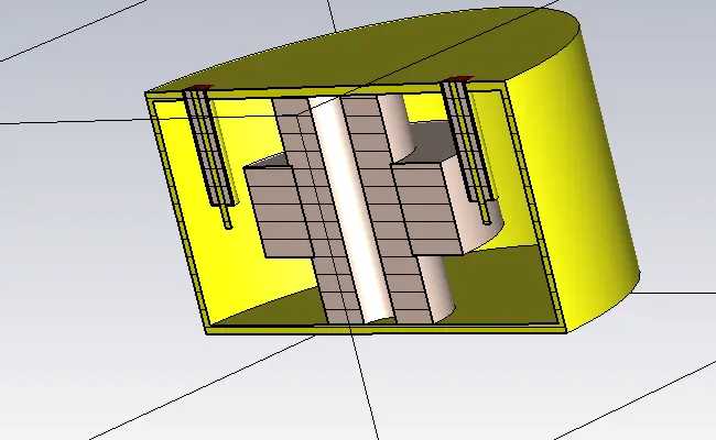

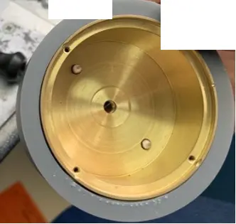

Hello, I have a wispering gallery mode at 10.24GHz, the resonator is a saphire cilinder which sits on a teflon.
I want to shift that mode to 14.5Ghz after that I need to do some tuning of the mode frequency.
I cannot change the saphire outer diameter as a way to do fine tuning for the modes frequency.
Is there some way giver the resonator structure where using some manual tuning of a screq or something I can tune the mode frequncy?
Thanks.
