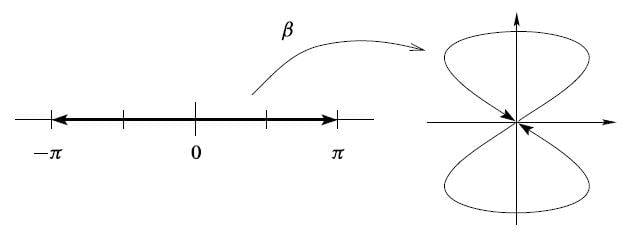

ok, consider the following Lemniscate curve ##\beta(t)= (\sin 2t, \sin t) , \text{ } t \in (-\pi, \pi)##
using the parametrisation above the tangent vector's components at point ##(0,0)## are ##(2,1)## whereas their limit for ##t \rightarrow \pm \pi## are actually ##(2,-1)##. That means there is not a smooth vector field ##X## defined on ##\mathbb R^2## such that restricted to the Lemniscate gives the tangent vector along it.
So the question is: is there a reparametrisation of the Leminscate's trace/image such that such a smooth vector field ##X## does exist ? This question is related to this thread.

Any idea ? In other words: does it exist a reparametrisation of the Leminscate's trace such that the module of the tangent vector (i.e. the velocity) is null at the origin ##(0,0)## ?
Note, that the vector field has to be smooth so it would require that the speed on the curve approaches 0 as it approaches the origin. So you are asking if there is a parametrization of the lemniscate such that the velocity is 0 at the origin and approaches 0 from the four directions bordering the origin.
My instinct is that his impossible but I have to think about it more to try and offer a proof.
Yes, exactly. That's my question.

A basic theorem is that the integral curves for a smooth vector field are unique. Which means that if you have a curve, ##c(0)=p## and ##c'(0)=0## then ##c(t)=p## is a solution and the only solution by the uniqueness theorem.
Conversely, if a smooth integral curve is an immersion then it is regular everywhere along that curve. Therefore, I am having a hard time imagining the reality of any of these examples.
Likes cianfa72
ok, so coming back to the lemniscate curve if it is an immersion as smooth integral curve then it must be a regular curve.
Yes. I was thinking about some examples, yesterday.
Imagine the curve ##(t^3, 0)##. This curve has zero speed at the origin so it isn't an immersion. If you try and solve for the associated vector field you get,
$$ x'(t) = 3t^2 = f(x(t)) = f(t^3)$$
Which has the solution the vector field, ##3x^{2/3} \partial_x## which is not smooth at the origin. Similarly if you try and parametrize your curve as a flow you find it isn't smooth. ##\theta(t,x,y)=((t+x^{1/3})^3, y)##.

If I get you correctly, doing the same for the lemniscate curve with zero velocity at the origin, we get a non-smooth vector field.
cianfa72 said:
ok, that makes sense.Sorry, your ##\theta(t,x,y)## should be actually the flow ##\theta_t (x,y)=((t+x^{1/3})^3, y)##. Then working out the derivatives w.r.t. ##t## and evaluate them at ##t=0## we get the vector field ##3x^{2/3} \partial_x##.
We have to be a bit careful. You can create a vector field that is 0 at the origin and flows around the lemniscate and approaches 0 at the origin. However, this will result in 3 integral curves, the stationary curve at the origin and one for the top and bottom loops.
Ah ok, since we get 3 solutions (integral curves) from the uniqueness theorem.
Anyway for the reasons pointed out above the lemniscate curve cannot be an integral curve of a smooth vector field defined on ##\mathbb R^2##.
