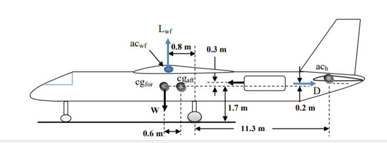

Okay, so this isn't so much a problem as a design issue while following an example given in a book.
(Relevant material is here: http://www.aero.us.es/adesign/Slide... 12. Desig of Control Surfaces (Elevator).pdf )
Now, the calculations require a mass moment of inertia about the main gear to be calculated in order to be factored into equations. Sure enough this is already provided in the example they give, but in order to make sure that while applying it to the design I'm making I decided to check my formula against the info given in the PDF...
The details of the airplane in the PDF are a total weight of 20 tons, Iyy 150,000 kg m^2, and this drawing of the plane:
What formula must I use for such an object.
For a slightly different design (instead of using a tubular body, instead using a flying wing-style cabin) is there a general formula that can be used - such as the one for a rod rotated at its end, etc.
The formula I used was that for a rod being rotated at its end (ML^2)/3 ... However that didn't come out right, no matter how I tried it. As a distance I tried using 1.1, 1.7, 0.6, 2.02 (hypotenuse that links CG and the main gear wheel), and several values between 8 and 12 (since the main gear seems to be right about the center, figured the distance to the nose would be the same)... Nothing comes out right - the only value that would fit is about 4m if my memory serves me right.
I then proceeded to try several formulas. The one that finally got me in that ballpark of 150 tons per square meter was the one for a rectangular plane rotating about an axis at its end ( m/12 * (4h^2 * w^2)) where I fed it 1.1 as height and 2 as width as that is the rough radius of a private jet like this. (to be noted, the design I'm personally working on does NOT use a round fuselage, it is more of a flying wing cabin design for two pilots).
I thought that this was finally the proper solution, but it didn't feel right... Also attempting this on other problems from this book, it still didn't fit quite right.

Hi yavorh. If I understand the problem correctly, you have the moment of inertia of the plane about a vertical axis through the centre of mass of the plane and you want to calculate the moment of inertia about a vertical axis through the main gear. If that is the issue, it should be a simple matter of applying the parallel axis theorem. But why does the plane have two centres of gravity (cgfor and cgaft)? Do they represent the centres of gravity with gear up and gear down?
AM
Typically if you wan't to work out the MOI of something complicated you...
1) Divide it up into regular shapes for which the MOI is known. (Examples here: https://en.wikipedia.org/wiki/List_of_moments_of_inertia and elsewhere on the web).
2) The tables will typically give the MOI about the centre of mass or an edge and you may need the MOI about a different point (eg the undercarriage or the CoG). So you "correct" the MOI of each part using the parallel axis theorem to give you the MOI about the required point. https://en.wikipedia.org/wiki/Parallel_axis_theorem
3) Add up the corrected MOIs to give the total MOI.

Thanks for the info thus far - I am trying to find the Mass MOI in kg/square meter about the main gear - the idea is to factor it into the calculation of how much force the elevator needs to produce in order to rotate the plane during take off.
In this case I'm not sure exactly how to calculate each objects MOI... Perhaps it'd be best to take each shape's CoG and calculate its MOI by using the formula for a point-weight (pendulum) rotating about the axis of the main wheel.

In that case, the pivot axis is a line between the points of contact of the wheels with the ground. So you have to work out the moment of inertia about a horizontal axis through the centre of mass of the plane and then apply the parallel axis theorem to find the MOI about the pivot axis.
To find the moment of inertia of the plane about a horizontal lateral axis through its centre of mass I would treat the plane basically as a non-uniform cylinder. Divide the plane up into short cylindrical sections along the long axis of the plane and find the mass per unit length for each section. From that work out the MOI of each section (each is a thick-walled cylinder) about a horizontal lateral axis through the section's centre of mass. Then apply the parallel axis theorem to find the MOI of the section about the parallel axis through the centre of mass of the plane. Then add them up to find the MOI of the entire plane about the horizontal lateral axis through the centre of mass . Finally, then apply the theorem to determine the MOI of the entire plane through the parallel pivot axis.
Just a quick note about units for the MOI, the units should be kg m2 not kg/m2.

Awesome! I just managed to find some similar info through this one book, but it wasn't as detailed on finding the CG MOI as you explained it. Thank you very much!
Since I was using this given above example as a base on which to test if the formulas I'm using on my own design are accurate, I'll probably have to treat the shapes as cuboids, since it's the simplest approach:
