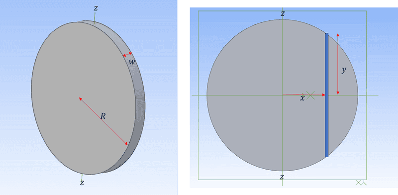

Apparently the Mass moment of inertia of a cylinder about the axis shown is ## I = \frac{1}{4}MR^2##
## \int_V \rho r^2 dm ##
The integral is a bit nasty.

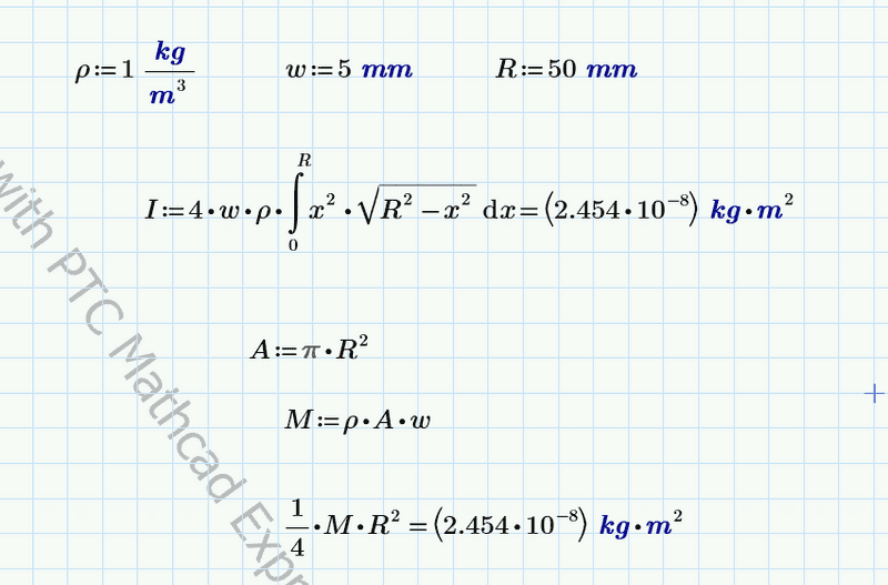

$$ I = 4 w \rho \int_0^R x^2 \sqrt{R^2-x^2} dx $$
Just inquiring if I try it, I'm not chasing an approximation, or verify someone gets/has gotten the result.
Never mind- I figured out how to confirm it with symbolic calculator. It does appear to be equivalent.

Well you can substitute x for Rcos$ and it would become way easier , i got the final value after putting in the limits (πR^2)/16 . Thanks
