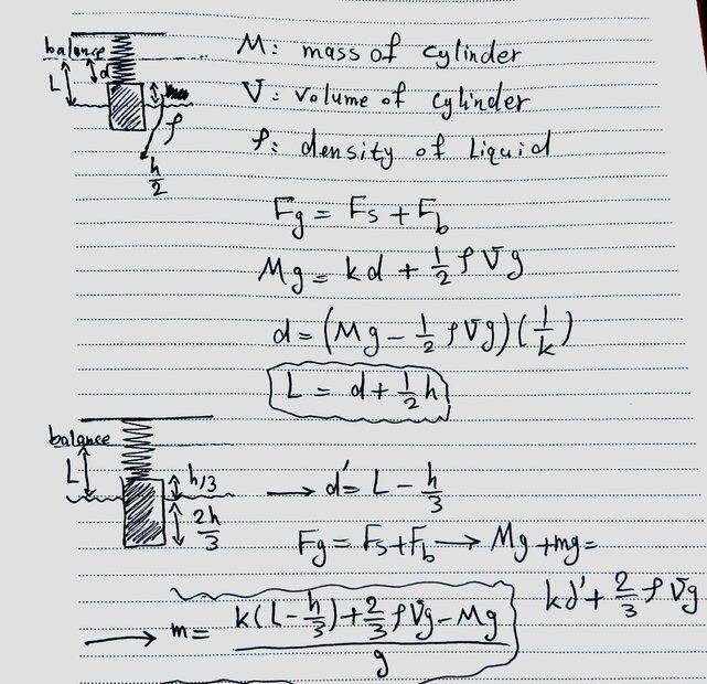

According to the figure, the metal cylinder with mass M and volume V is connected to a fixed point from above by a spring with spring constant k and it floats inside a liquid of density p so that half of its height is inside the liquid. What weight should we put on it so that two-thirds of the height is inside the liquid?
Fluid mechanics.
Hi , Can someone tell me wether my answer is corrrect or false ?
I'm getting something different from you. The difference is I define ##d'## in terms of ##d## and ##h## differently. Actually, they work out equivalently. If you just eliminate ##Mg## via your first equation, and put ##L## in terms of ##d## and ##h## , I think we will get the same result.
My end result is purely a function of ##k,h,\rho,g,V##
