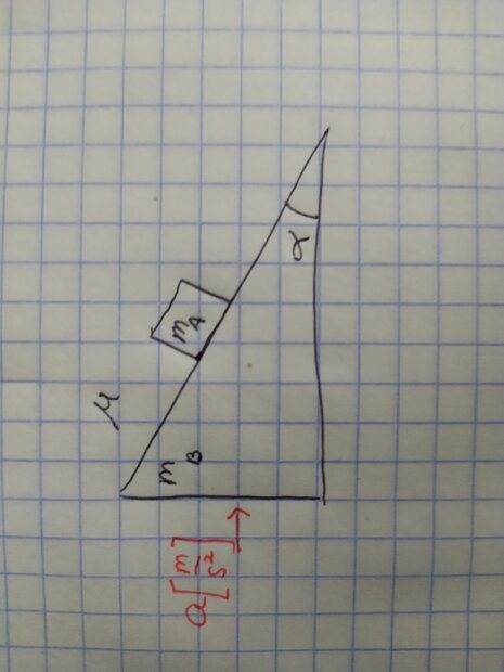

Hey everyone, i run across this quastion and i don't know hot to find the min and max of a
Fk = miu*N
Body A rests on a inclined plane of body B . the angle of slope is α , the coefficient of friction between the two bodies is μ . Body A does not slip on body B because we accelerate body B with a. What is the minimum and maximum acceleration required for body A not to slip? What will be the results if the slope angle α is 0? What will be the results if the slope angle α is 90°?

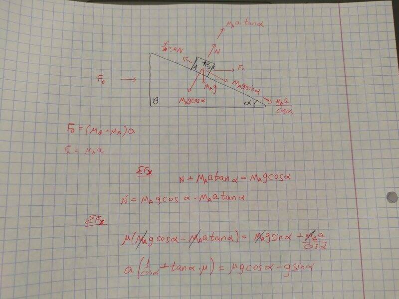

this is what i did, but i got a expression for a but i don't know how to find the min and max

york said:
you right, sorry.
I disagree with your first equation ("N+..."), and with the RHS of the third one. In each case, it's the coefficient of the a term I question.
Re min and max, what may happen if a is too small? What if a is too large?
if a is too amall the block A will slide down, and if a is too large i think the block will severed from the plane backward
Sorry, I don't know what you mean by that.
What about the errors in the equations? Please explain how you get those terms.
