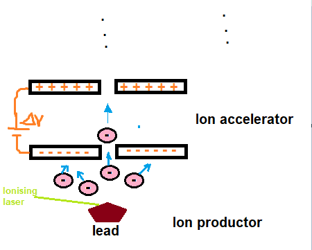

Summary:: How to load the plates with the Lead element in the spectrometer
I have a mass spectrometer with lead element which has an electronic configuration 1s^2 2s^2 2p^6 3s^2 3p^6 3d^10 4s^2 4p^6 4d^10 5s^2 5p^6 4f^14 5d^10 6s^2 6p^2. It has 2 free electron, so the ejected electrons go through the ion accelerator and here, to speed the electrons I thougth the plates' charges must be like that (above must be +, below must be -). It's right or not?
And also I have a table like :
Lead IsotopesRelative AbudanceDecaysIsotope Mass(AMU)
Pb2041.4%Stable203.978
Pb20624.1%Stable205.974
Pb20722.1%Stable206.975
Pb20852.4%Stable207.976
Lead100%207.2
I have a statement like "The ionized isotopes are in Pb^- form. That is only a single electron is missing in lead ions. The number of ionized isotopes entering into the accelerator region corresponds to a 1μA ion current.". What does it mean that Pb^- form and 1μA? I also wondering that which isotopes will I use to find Vacc, Eacc etc.

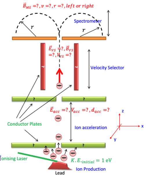

The question is here. I thought someone with knowledge of spectrometers could easily answer the question I asked at #7, but it's OK.
1.The mass difference between two isotopes is sometimes just a neutron mass. The spectrometer should separate them very well. For such an isotope combination, the difference in radius should be around 1 cm. That is r2-r1=1 cm. In order to achieve this, choose a magnetic field with a magnitude in Tesla (maximum magnetic field you can obtain from a conventional magnet is around 2.5 T so be far away from this value) and choose the direction also. Then determine the velocity of isotope you need. Last calculate radius r of a smallest isotope Pb-204.
2.In order to produce this magnetic field, determine the current and number of turns, radius and other parameters of a solenoid you need. Also show how you will position this solenoid.

After a short break, I'm here again. I would like to tell the process;
I selected Pb207-Pb206 isotopes combination and did the calculation as selecting the isotopes masses(amu). So we know the difference in radius between two isotopes r=0.01m, B=0.5T, Qe = 1.60*10-19 , and r= (m.v)/(q.B). I found 8*10^-22 = 3.44*10^-25*v2-3.42*10^-25*v1. So I can't found v1 or v2 for now.
Does it help us to find the velocity of Pb204 that we are asked to find velocities of these besides? The radius and velocity of Pb204 is unknown afterall.

It's asking you to find the velocity you need to produce the (r2-r1) you need, given the magnetic field you have chosen. When they say "determine", they mean "calculate" in this case. I think you are confused because you have two different masses, two different radii, and two different velocities. You need to eliminate one variable. The easiest way to do this is to recognize that you are accelerating the ions through some voltage V. When you do this, the ions will have an energy E = q*V, regardless of its mass. Then, since E = 1/2 * m * v^2 (note small v = velocity, capital V = voltage), you can then write [itex] v = \sqrt{\frac{2 E}{m}} [/itex]. So then you can write: [tex] r = \frac{m \sqrt{\frac{2E}{m}}}{qB} = \frac{\sqrt{2 m E}}{qB}[/tex] [tex]\frac{r}{\sqrt{m}} = \frac{\sqrt{2E}}{qB}[/tex]
Now the part on the right hand side is the same for both masses, so this means that [itex] \frac{r_1}{\sqrt m_1} = \frac{r_2}{\sqrt m_2}[/itex], which means you can write [itex](r_2 - r_1) = r_2 (1 - \sqrt{\frac{m_1}{m_2}})[/itex].
Now you know r2-r1, m1, and m2, so you can calculate r2, then you can calculate r1, and then you can calculate v1 and v2, and then you can calculate the other things you've been asked for. Does this make sense?
In spectrometer region:
because of (r2 - r1 )= r2(1−√m1/m2) --> 0.01 = r2(0.003) --> r2 =3.33m, r1 = 3.32 m.(m1 = 3.42*10-27x205.974 = 3.42*10-25, m2 = 3.42*10-27x206.975 = 3.44*10-25)
2 for Pb207, 1 for Pb206 so I chose first one(2 (Pb207))
So FB = q(vxB) = qvB and circular force = FC = mv2/r. FB = FC --> 1.60x 10-19Cx(0.5T) = 3.44x10-25.v2/3.33m --> v2 = 0.77x106m/s. I jumped ion acceleration region because of there is not applied force or changing in velocity selector region.
In acceleration region:
Ui- Uf = Kf - Ki --> (Ui- Uf = delta V = Vacc )
Because of Ki = 1eV = 1.60x10-19 joules, I found Vacc =1.02x10-13. After that, there is one thing we have to do = Eacc = V/d = 1.02x10-13/1m = 1.02x10-13 (distance between two parallel plates d = 1m)
I hope I calculated everything correct as yet. But in that calculations I didn't have to calculate the things in the velocity selector region. So what will I do for finding these? After I find these, I think there is one think to do that calculate for the smallest isotope Pb204. At least I understood so. And also I think that we are making progress.
OK, good progress. A couple of comments:
(1) I got somewhat different numbers for r1 and r2, because you rounded off (1-sqrt(m1/m2)) to 0.003. I would keep a few more digits there (.0024 or .00242). This will change the r and v values somewhat.
(2) On the voltage calculation, Uf-Ui = q*Vacc. You forgot the q. Your voltage value is much too small. It should be many thousands of volts.
(3) On the velocity selector region, try reading this link. It explains what the velocity selector does and how to choose the E and B field:
http://physics.bu.edu/~duffy/semester2/c13_massspec2.html
