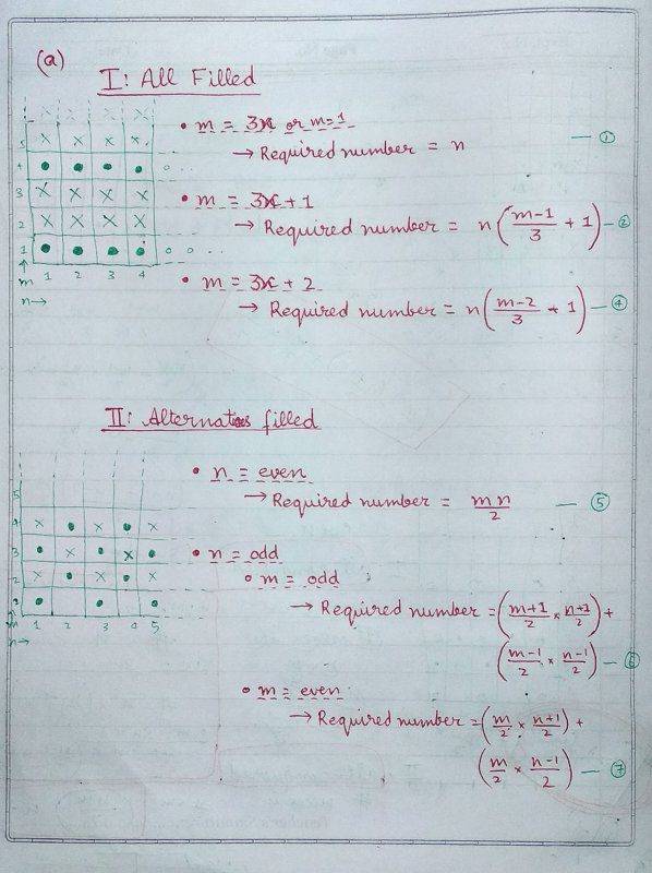

11.
Answer the following questions:
a.) (solved by @mmaismma ) How many knights can you place on a ##n\times m## chessboard such that no two attack each other?
