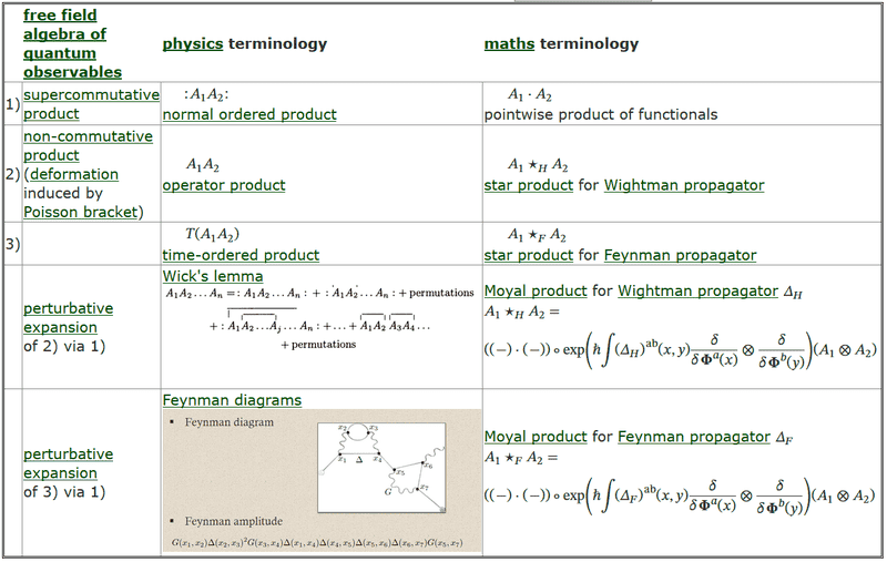

bhobba said:
is your view similar to making the vacuum energy zero by normal ordering?
Yes, renormalization of time-ordered products is a phenomenon directly analogous to that of normal ordering in the Wick algebra.
(I wish this were "my" view, as you suggest, but instead this is what we learn from Brunetti-Duetsch-Fredenhagen et al.)
In both cases we have a product of observables that is fixed when all arguments are regular observables (def. 7.13) and we ask for the freedom of extending that product to all observables.
For the Wick algebra (chapter 14, section 1), which on regular observables may be given as the star product ##\star_{\tfrac{i}{2}\Delta}## of the causal propagator, for its extension to the diagonal to exist we may add a symmetric contribution ##H## to ##\Delta## (by prop. 13.6) and the choice that works gives the star-product of the Wightman propagator, and that is the Wick algebra product. The role of ##H## is precisely to subtract those contractions that give normal ordering. (The formula for the star product of the Wightman propagator is the algebraic manifestation of Wick's lemma.)
Similarly, the time-ordered products are uniquely fixed on regular observables to be given by the star product of the Feynman propagator (chapter 4, section 2). Again there is a choice to be made as one extends from there to the full algebra of (microcausal) observables, and that choice now is called renormalization (prop. 16.1)
The close analogy between these two cases is meant to be summarized by that table which is shown at the beginning of chapter 14. (see also the text right above, there):
