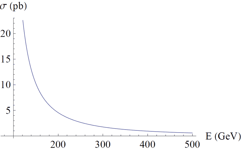

As you can see, all these products approach a constant for E →∞. Hence the cross-section goes to zero in this limit as
[itex]
\begin{align*}
\sigma =& \,\frac{E^2 - m_{\mathrm{w}}^2}{32 \,\pi E^4} \int_{-1}^1 \langle |\mathscr{M}|^2 \rangle \,\mathrm{d} \cos\theta \,.
\end{align*}
[/itex]
From the code I doubt whether you use my (axial gauge) convention for the photon polarization sum...

or do you? In this gauge, the energy behavior of M3^2 must be the same as for the other products.
Frankly, I don't understand the assignment phi = theta in your code. These angles are completely independent, aren't they?

There, With your gauge I get:
[tex]
-\frac{4 \text{gw}^2 \text{Qw}^2 \left(7 \text{En}^4+\left(\text{En}^2-\text{Mw}^2\right)^2 \cos (2 \theta )+2 \text{En}^2 \text{Mw}^2-\text{Mw}^4\right)}{\left(\text{En}^2-\text{Mw}^2\right)^2}
[/tex]
Which goes to
[tex]
-4 \text{gw}^2 \text{Qw}^2 (\cos (2 \theta )+7)
[/tex]
as En -> inf.
So maybe you just did your calculation wrong? All I did was replace the photon sum with yours and defined "r" and the scalar products.
**note : It may take a while to do the amplitude squaring if you don't have a decent computer. A few minutes probably on most normal machines.
  • PF3.nb
@ Hepth: I carefully analyzed your code: I understand the structure and I did not find any mistakes, so I guess that the answer is right! I made a plot of the total cross-section as a function of the total energy (W boson mass is the threshold energy). Sigma goes to zero for E to infinity, as it should :) Thanks a lot!
