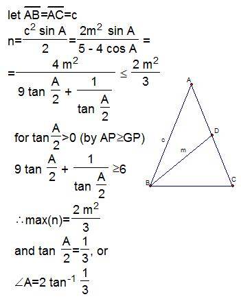

$\triangle ABC, \,\, AB=AC$,point $D$ is the midpoint of $AC$
if $BD=m$,and $n$=area of $\triangle ABC$
please find $max(n)$ and corresponding $\angle A$

Here's one approach...
Parameters {x,y}:
C={x,0}, B={-x,0} A={0,y} implies D={x/2,y/2}
Set Scale: try m=3/2
Extremes:
then y=0 implies x=1 and n=0
then y=3 implies x=0 and n=0
get y(x) for m=3/2
Solve case m=3/2 and scale for general case

hint :use law of cosine
