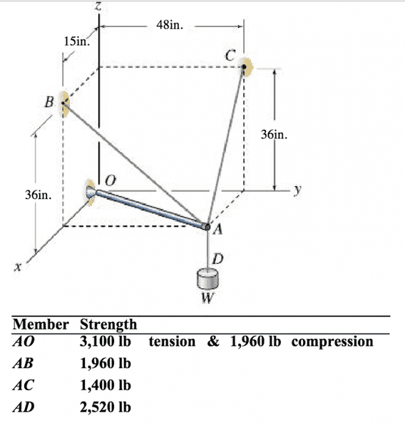

A weight W is supported by bar AO and cables AB, AC, and AD. Point A lies in the xy plane, if the bar and cables have the strengths listed below, determine the largest value W may have.
Hint given: A FBD of joint A is recommendedto being this problem. Bar AO should be assumed to carry load along its length. Unit vectors point from A to B and from A to C are needed to describe the direction of cable tensions. Since cables are required to be in tension, it should be clear from the figure that AO will be in compression. It is usually not obvious which structural member first reaches its limit load. Loads carried by each member should be obtained in terms of W. Individual failure criteria can then be applied to each member to find W inducing failure in that member. The largest weight that may be supported is the minimum of this set of failure loads.

First I drew out the FBD which was basically exactly the same as the picture given so I didn't find it necessary to post it. Then I found the point coordinates to be:
A (15,48,0) in
B (15,0,36) in
C (0,48,36) in
O (0,0,0) in
Like the hint suggests, I found the unit vector of AB and AC to be (0,-4/5,3/5) and (-5/13,0,12/3) respectively.
Then I multiplied those by the strengths given making the, equal to (0,-1568,1176) for AB and (-538.5,0,1292) for AC. The problem statement says the force of AO is already in it's direction so AO would be (29400,94080,0).
From here I don't really know how to go about "Loads carried by each member should be obtained in terms of W." I just need a good push in the right direction.
Thank you so much for any help, I really appreciate it!

Because W is the only load applied to this structure. All of the loads in the cables and the bar OA are produced by this one load; hence, it stands to reason that these loads will also be proportional to the magnitude of W.
Like I said in my previous post, you'll have to solve for the loads in each member using the equations of static equilibrium. The cables will be in tension, because they don't work if they're not, but the bar OA will probably be in compression.

The equations of static equilibrium are:
ΣM = 0, ΣFx = 0, ΣFy = 0, ΣFz = 0
Thus, there should be no net force and no net moment acting at point A.
If you are not comfortable with using W for the load on the structure, then assume for the purposes of this calculation that W = 1 lb or 100 lbs or 1000 lbs, whichever value is more convenient. The forces in the structure you obtain from your calculations can then be scaled by this assumed value to find out their proportion to the applied load W. Then, you may use the values from the table to find out what the actual maximum magnitude of W is such that the structure is not overloaded.

You should start by calculating the unit vectors for cables AB and AC and the bar OA.

Now, the forces in the cables, call them FAB and FBC, along with the force in the bar, FOA, are all unknown at this point.
By multiplying the magnitude of each force by the corresponding unit vector for the member, you can obtain the components of each force. These components are then used to write the equations of equilibrium for this structure. You can write a single force equation each for the x-, y-, and z- directions. You can also write one moment equation.

No, they are not. You must find the forces in the members before you can use the loads from the tables.
The forces in the members will be some factor times W for each member.

We need to find the magnitudes of the forces, not the lengths of the members.
You must use the equations of static equilibrium to find the magnitudes of these forces.

You don't seem to be grasping the concept here.
The unit vectors for each member are as follows:
OA: (-0.2983, -0.9545, 0.0000)
AB: ( 0.0000, -0.8000, 0.6000)
AC: (-0.3846, 0.0000, 0.9231)
Multiply each member's unit vector by the corresponding magnitude of the unknown force:
FOA = FOA * (-0.2983, -0.9545, 0.0000)
FAB = FAB * ( 0.0000, -0.8000, 0.6000)
FAC = FAC * (-0.3846, 0.0000, 0.9231)
The vector for the weight W is simply W = W * (0, 0, -1)
If you want to write the equations of equilibrium, then you use the force vector components defined above.
For example:
∑ Fx = -0.2983 * FOA - 0.3846 * FAC = 0
I'll leave it to you to write the equations for ∑ Fy and ∑ Fz
∑ Fy = -0.9545 * FOA - 0.8000 * FAB = 0
∑ Fz = 0.6000 * FAB + 0.9231 * FAC = 0
EDIT: ∑ Fz = 0.6000 * FAB + 0.9231 * FAC - W = 0
There isn't enough information here to find the forces since there isn't one equation that has a value for x, y and z. :oldcry:

Well, we haven't finished writing all of our equations of equilibrium. These are just the force equations.
There is still one equation to be written for the sum of the moments about point O, ∑ MO = 0.
I don't know if you've learned how to calculate the moment of a force vector using the cross product,
or M = r × F.
Three equations, three unknowns
or M = r × F.
We did nothing like this for the examples my professor did in lecture for this homework, but I do know how to take the cross product. What is r in this case? I know it's the radius vector. And F is all the components we just found added together?
Alison A. said:
Three equations, three unknownsWe did nothing like this for the examples my professor did in lecture for this homework, but I do know how to take the cross product. What is r in this case? I know it's the radius vector. And F is all the components we just found added together?
You're close.
At point A, all of the forces in this structure created by the weight W come together. Since we have only one moment equation available, it's probably best to take Point O as the reference point for the radius vector r to each force.
Normally, if we were dealing with several known forces acting at point A, we would just find the resultant force R at this point and then calculate the moment vector as M = r × R. Since the forces on this structure are unknown, except for the one due to the weight W, it is easier if we compute r × F for each force at point A, with the same r being used in each calculation, that is vector OA. Once the individual moment vectors are calculated, their individual components can then be summed in a fashion similar to what was done with the force vectors.
SteamKing said:
You're close.
Ok, so
OA x AB = (-0.5727, 0.1790, 0.2386)
OA x AC = (-0.8811, 0.2753, -0.3671)
and we already know OA x OA is going to be (0, 0, 0)
I hope this is right by crossing the unit vectors and not just the coordinates...
ΣFx= -0.5727 - 0.8811 + 0
ΣFy= 0.1790 + 0.2753 + 0
ΣFz= 0.2386 - 0.3671 + 0
Alison A. said:
Ok, so
Let's try this again by way of an example:
Suppose we want to calculate the moment of the force vector FAB about the point O.
In other words, MAB = rOA × FAB:
rOA = (-15, -48, 0) in.
FAB = (0.0, -0.8000, 0.6000) * FAB lbs.
We can set up the cross product determinant like so:
Code:
rOA x FAB =
|  i      j       k     |
|-15     -48      0     |
| 0.0000 -0.8000  0.6000|
rOA x FAB = [(-28.8), (0+9), (12)] * FAB = FAB * (-28.8, 9, 12) in-lbs
where FAB is the unknown magnitude of the force vector FAB.
To solve this problem, additional moments need to be set up and computed: rOA × FAC and rOA × W
The moment rOA × FOA = 0 by definition.
FAB = (-28.8, 9, 12)
FAC = (-44.31, 13.85, -18.46)
W = (48, -15, 0)
Do these look right?
ΣFx = -FAB(28.8) - FAC(44.31) + W(48)
ΣFy = FAB(9) + FAC(13.85) - W(15)
ΣFz = FAB(12) - FAC(18.46)
W = (48, -15, 0)
These are not forces. They are moments, so they should use different notation. There is also a minor omission in that each moment vector should be multiplied by the magnitude of the associated force:
MAB = FAB * (-28.8, 9, 12) in-lbs.
MAC = FAC * (-44.31, 13.85, -18.46) in-lbs.
MW = W * (48, -15, 0) in-lbs.
These equations should also have similar corrections made to indicate that you are dealing with moments and not forces.
Each of the equations below should be set equal to 0, since at equilibrium, ∑ M = 0.
ΣMx = -FAB(28.8) - FAC(44.31) + W(48) = 0
ΣMy = FAB(9) + FAC(13.85) - W(15) = 0
ΣMz = FAB(12) - FAC(18.46) = 0
Note that the equation ΣMz = FAB(12) - FAC(18.46) = 0 can be used to find FAB in terms of FAC
Once you have done this, then the force equations:
can be used to find the magnitudes FAB, FAC, and FOA in terms of the load W.
You've done good work up to this point. Keep working. You're only a couple of steps away from finding the maximum value of W.
So I am finding all the forces from the moments first then applying those to the force equations?
  • #31
No, you use the one moment equation I indicated,
ΣMz = FAB(12) - FAC(18.46) = 0 to find FAB in terms of FAC
Then, you can substitute FAB back into the force equations to find the other forces in terms of W.
  • #32
Alright I found FAB to be (4615/5539)W and FAC to be (3000/5539)W
  • #33
And from there force equations I found FOA to be -0.6983W
  • #34
WOOOOOOOOOOOOOO:oldsurprised: I got the right answer. Wow that was a lot of work, I think I've gone through about 10 pages of paper. :bow:Thank you so much for sticking with me even when it seemed like I couldn't grasp the most simple concepts . Could you help me find the last part to my other problem you've been answering? That is my last problem... then I'm finally done.
