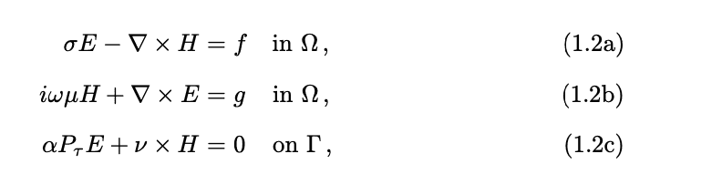

Hi everyone,
I'm trying to understand the purpose and functionality of absorptive boundary conditions used in simulations of electromagnetic fields. Specifically, how do this conditions 1.2c):
with
(and ν the unit outward normal on the boundary Γ; Pτ , the projection of the trace operator)
simulate an open boundary and prevent reflections within a bounded computational domain? Any insights into their physical interpretation or practical implementation would be very helpful.
References:
https://www.semanticscholar.org/pap...ntos/64177e2129da814049dba96c0478821aa8bb8224
https://epubs.siam.org/doi/pdf/10.1137/S0036139995289234
Thank you!
Baluncore said:
Welcome to PF.
If the impedance is matched, there will be no reflection.
Space cloth. https://en.wikipedia.org/wiki/Space_cloth
Thank you for the answer. But how does condition 1.2c) enforce that ?
gltau99 said:
and how does condition 1.2c) enforce that ?
Can you add a link to your reference please? Thanks.
