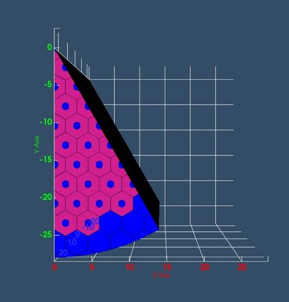

I'm trying to use FMESH command to get power distribution of this core geometry.
I want to use xyz coordinate in a 1/12 slice of a core so I could use the output of the MCNP sim for a CFD input
How should I approach this?
Thank you

I don't think FMESH is going to work for you because FMESH uses an x-y-z grid and your reactor geometry is hexagonal. Even if your reactor was on a square grid, it still uses circular fuel rods, so FMESH isn't going to work.
What are you transferring to the CFD calculation? As @Grelbr42 suggested, if you are transferring the fission power from the rods, you need to define F6 tallies for each of your fuel rods. You also need to be very careful with the normalization. Make sure you are getting all the reactions (flux times fission times energy per fission) and the volume in the tally is correct.
If you are transferring energy from downscatter and gamma capture in the moderator, you will need to define F6 tallies for these regions as well.
You will have to manually map the power from each tally number to the correct region(s) in your CFD model.

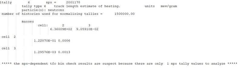

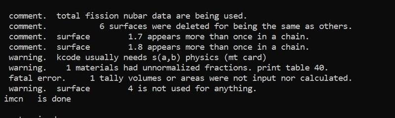

I end up using F6 just to see my MCNP power output match the power output listed in the reference paper.
MCNP give me an error every time I put cell 4 or 1 in the tally even though the fuel is located in those cells.
Secondly, can someone help me interpret the tally output. As far as I can understand, I need to multiply the number of particles with the those tally numbers to get energy in MeV per gram of material, is this correct? And because cell 2 and 3 don't have any U235 in them, these value are just from collision heating?

The fatal error is that the program can't determine the volume of the cell automatically. So you need to specify the volume, for example with a vol= on the cell definition line for every cell you want to tally that has a zero value in the cell volume table (there will be a note saying why it failed to calculate).
It may help to split the model in the z direction, because the flux in the middle will be different to the flux at the top and bottom. There are a few ways to do this, including using the lattice to tile it for you, but it's not something to worry about until the input file works.
How should I define the volume? Should I put the volume of individual fuel elements, all fuel elements in the slice combined, or the volume of the slice itself?
That is actually a more involved question than I was prepared for. I'd put them in cell definitions 3 and 4. So long as your thermal model matches I don't think you then need any corrections for the partial rods, you just need to remember that the total power of the simulation is 1/12th of the design goal.
Sorry I didn't quite understand your answer. Yes, I will add volume definition in cell 3 and 4 in the code.
My question is, how should I calculate the volume of each cell? For example, in cell 3, the coolant channels, should I put the volume of a single coolant channel or should I put the volume of all coolant channels in the reactor slice?
Single cell volumes in 3 and 4 and then see if that fixes all the errors.
The center rod is only 1/12th exposed to flux so it's tally is 1/12th what the real rod is exposed to, other rods are half exposed or fully exposed. So long as the geometry matches the thermal code this should not be a problem. If the thermal code isn't the same 1/12th segment then some multiplying needs to be done.
