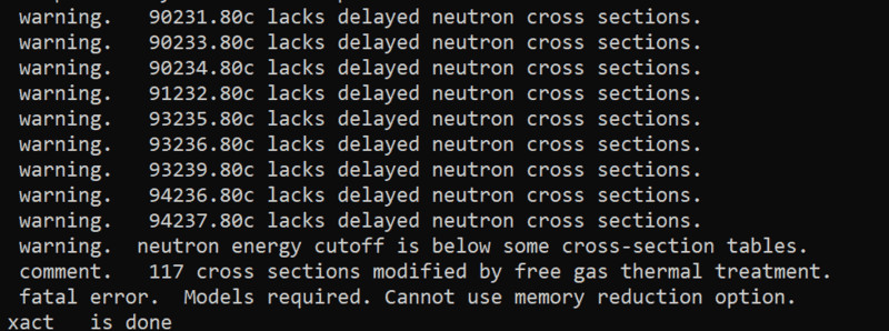

MCNP6 Fatal Error : Models required
In summary, the conversation is about a problem with the BURN card and the need for a model. The code provided is for a DU-10Zr fuel pin and assembly.
tysonman166
TL;DR Summary
Hi! so its me again. After previous problem already solved now i ran into another problem. now about BURN card. its said need model? what kind of model?
Hi! so its me again. After previous problem already solved now i ran into another problem. now about BURN card. its said need model? what kind of model? I tried using .84c for all my material but doesn't seems to work!
heres my code if anyone wants to try :-(

So turns out for the warning i just need to add OMIT function. But the fatal error still there.. many help...?

Ok, few questions. What happens when you explicitly turn on the extended physics models?
Code:
MPHYS ON
You are using KCODE with no MT cards, is this intentional?
You are using a DF card with no DE card, is that intentional?
X does not produce an error, but all the source neutrons die. Which suggests a compatibility problem or a geometry error. I don't know X or 6 well enough to know which easily.

Usually the model is offered by the data table included in the list (.80c etc.) so MPHYS doesn't needed. For the MT and DE yes its intentional bcs MCNP will set it to the default for each of them. I think the problem lies in OMIT since there are other threads with similar problem.
https://www.physicsforums.com/threads/mcnp6-2-burn-problem.1012751/
The OMIT method does work (and does not simply omit the isotope). Right now everything feels like a fudge.
Problems first. Existing OMIT line contains an error. And also actinides. Which is a really strange thing to do. The library YUMMY is old and incomplete, especially the ENDF-V based part chosen. One of the reasons the @mhovi / @nukecore code works so well is that it let's MCNP find the libraries. It seems problems occur especially readily if MCNP cannot identify that a xx000 is a collection of isotopes and letting it roam wild seems to fix that. This may not be ideal, and may mean that the answer to an input file depends on exactly what libraries are installed, and may be even what order they are in the xsdir file...
Removing the library restrictions and the OMIT, produces the fatal error after which is this list,
Code:
The following nuclides use physics models rather than data tables:
            6014.  c
            7016.  c
            8018.  c
            9018.  c
           90234.  c
           91232.  c
So I construct a new OMIT line.
Code:
OMIT= -1,6,6014,7016,8018,9018,90234,91232
I like @nukecore 's -1 trick, I assume it makes it apply to all materials. I don't see this in the manual.
Running it now produces a more familiar error and it quits a lot earlier than X did.
Code:
Geometry error:  no cell found.
      run terminated because  10 particles got lost.
If you have a proper install of 6.2, you probably have ENDF-VII or VIII so it may be worth redoing the OMIT line, in the original one of the ZAIDs was a typo, and it was a mixture of commas and &s, which maybe it didn't like. You may also get away with specifying a library, which may let you set temperatures with less fudging. I haven't wrapped my head around the lattice, so I can't offer any help on the geometry issue right now.

Hi Alex, thank you so much for your help, now this problem finally solved and i can focus on the geometry now.
Many thanks and let me know if can help you in the future ^__^
